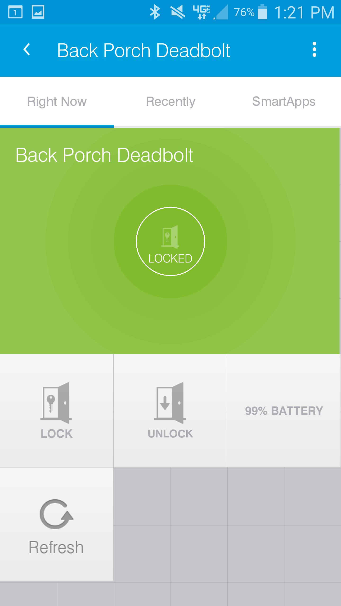

You can still do this, or at least I can with my locks. Under the second tab (the one with “rooms”, “things”, “smartapps”, etc.). Go to “things”. Expand the options for your lock. Along the top of the screen you will see lock specific tabs. The third one over is “Smartapps”. Click there and you will see a list of various smartapps relevant to the lock. One of those is Know/Control. In that Smartapp is a “Know when locked/unlocked/both” feature. It sounds like that is what you are looking fit.

I’m not sure if there us something particular about my setup our not, but I have no custom smartapps for lock notifications. I’ll attach the exact screens I see - but before I do that, it is possible that the lock and an associated open/close sensor must be configured as a door before you will see all the options. All my locks are associated with doors in my house.

Screen shots attached.
Per my previous post, I believe you must have the lock associated with a door in order to access this functionality. I do have a custom smartapp I wrote to turn on lights when a door is unlocked or locked. That could be easily modified to provide notifications if you are interested.

yes your picts show v1 on v2 there is no such smart app. and fx is not the same.
