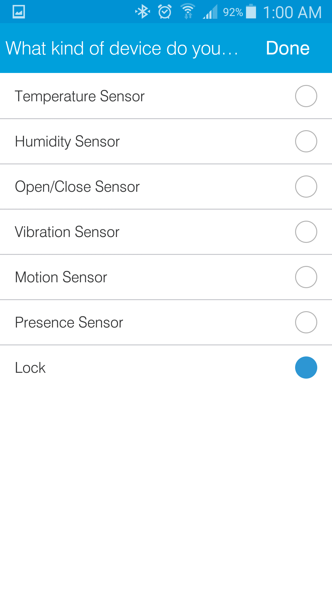

I was able to get notifications setup anytime my lock was locked/unlocked.
Below is what I did:
From the Dashboard, click on the three vertical dots on the top right and select “Configure”.
Select "Custom"
Select "New monitoring rule"
Tap on “What kind of device…” and select "Lock"
Should be pretty self explanatory from that point on…

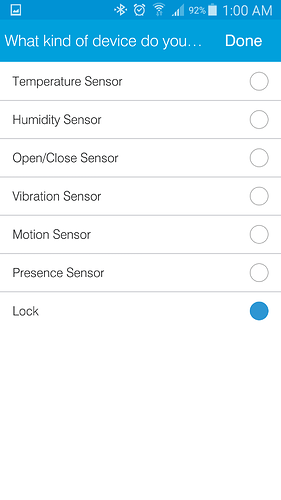

Snapshots below are from an Android but I see same options on iOS. Haven’t tried it on a Windows phone yet.
Anyone else have success with this? I don’t see the same options on iOS and can’t get notifications to work.
What app are you using?
Yes it works on hub v2 following the screenshoot on ios
