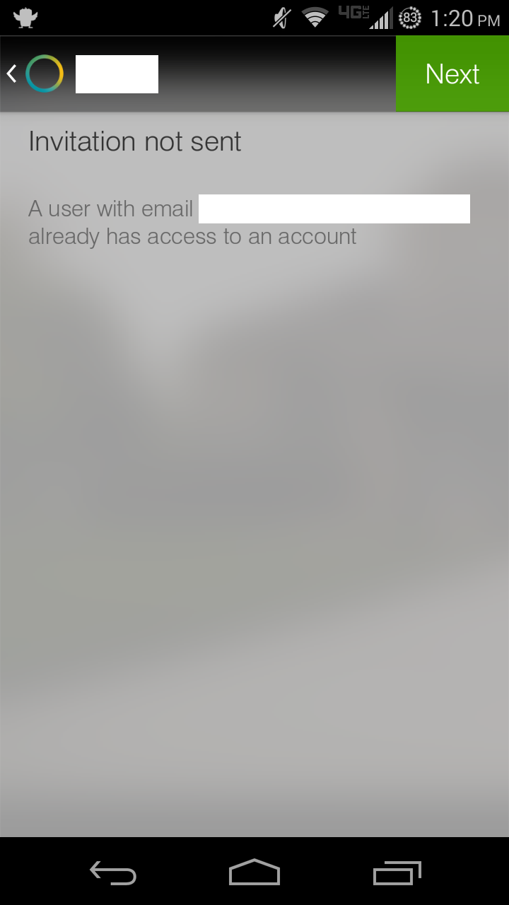

So, either I’m an idiot, or I don’t think multiple accounts really works with the Android app. I can’t seem to find any way to “invite” users and the following post, while old, indicates this as well:
http://blog.smartthings.com/how-to/adding-a-user-to-your-account/
I’m assuming this is an iOS only feature for some reason?
#15
You can invite users on Android from Home and Family. The “Manage Users” menu is coming up in the next release.
To do so, open Home and Family, click the gear at the top then add a person. You’ll see the option to invite them via their email address there.
A bit of a workaround, but both apps will be the same in this respect shortly.
(Brandon) #16
I see it now. What if I already created an account for the user not seeing any of these before?
#17
Hop on live chat at http://support.smartthings.com or email us if you don’t have 2 or 3 minutes right now.
