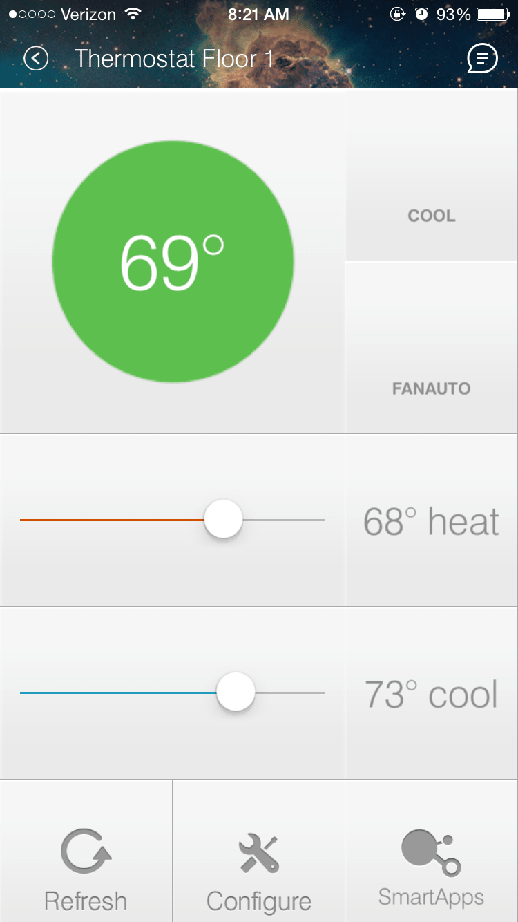

When you tap on the little gear next to it’s icon on the Things page it doesn’t show? You might not see the two pending modes.
There’s plenty of items that show, just not the state of the equipment.

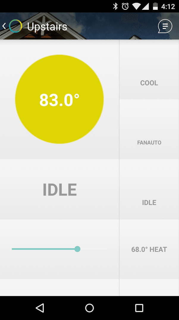

For example in this screenshot, it does say “Cool”, but that’s just the mode it’s in. It’s summer so I have it in air conditioner mode (aka Cool).
What I’m looking for is whether or not the equipment is on or off. I would like it to say “Idle” or “Cooling” so that I know what it’s doing.
I don’t see that anywhere here. Thoughts?
Good observation. I don’t have one yet so I’ve only seen it in simulator. I thought where it said cool went to idle when the call for cooling wasn’t active but that makes sense that it’s just showing the mode. I’ve been looking to get one and that would bother me too.
I wonder if anyone has made a custom device type to show this mode. I know somebody who always has a good answer, so let’s see if @yvesracine has any ideas.

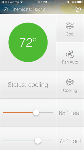

This was pretty helpful actually. By using the existing template I was able to make your changes. Now I just need to figure out how to apply it to my thermostats (or add a new thermostat with this custom device type).
Ok I guess that wasn’t hard at all. Thankfully there was the template to work off of, and your code makes perfect sense!
Once I edited my device online, and associated the “Type” to my new Device Type, it looked just like yours.
Great! Now I might be able to tweak it a little more to my liking - but so far so good!

Then go to My Devices and click on your Honeywell thermostat. At the bottom click Edit.
In the Type drop down box, select the Honeywell Custom Z-Wave Thermostat.
Click save, and open the app on your phone. It should look like the screenshot above.
