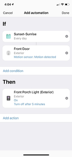

In the SmartThings app, in the If section, choose Add Condition.
Choose Time
On the next page…
  • choose “Period of Time” at the top.
  • below that, highlight “Start”
  • below that, highlight the “Night” tab
The Start time should now say “Sunset” and the End Time should now say “Sunrise”, but there’s a bug in the app (current iOS app on iPhone 11 Pro) where that will show as “Sunrise” for both the Start and End times. However, just ignore that and assume it means “Sunset” as the Start Time and “Sunrise” as the End Time. (Maybe @blake.arnold or @Lars can have someone fix that display bug. Same thing happens if you choose the Day tab, as it will display “Sunset” as both the Start and End time, when the Start should display Sunrise but incorrectly shows Sunset for both Start and End). Later in the automation editing process you should see it showing correctly as Sunset to Sunrise.
Click Save, then you’ll get what seems like an error, that it can’t save the automation. This message explains that “Period of Time” must be used along with other conditions”. Click OK, then add your motion sensing condition.
The above post explains how to set the Sunset-Sunrise time period for the Automation condition.

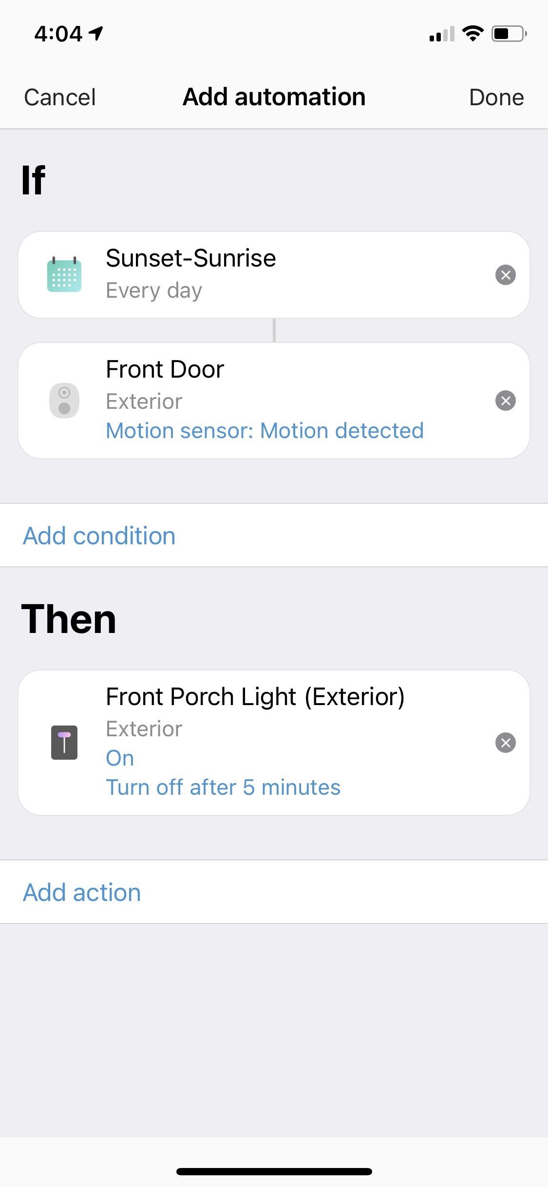

You can set up something like this:
However, I’m not entirely sure of the best way to set up the automations to accomplish exactly what you want, because I’m not totally sure how SmartThings treats motion sensors and the timers associated with them.
Using a single automation, as shown in the screenshot above, should mostly work. But, I would assume that it would turn off the light 5 minutes after the point when motion is first detected (when the light turned on), EVEN if there’s been frequent motion since then. At the 5 minute mark, the light would shut off and you’d have to have new motion to turn it back on.
Another way to do this might be to have 2 automations: one that turns the light on when motion is detected (but never shuts it off), and a second automation that turns it off when there’s no motion detected for 5 minutes. Then, it will turn on at the first sign of motion but won’t turn off until the motion has subsided for 5 minutes.
