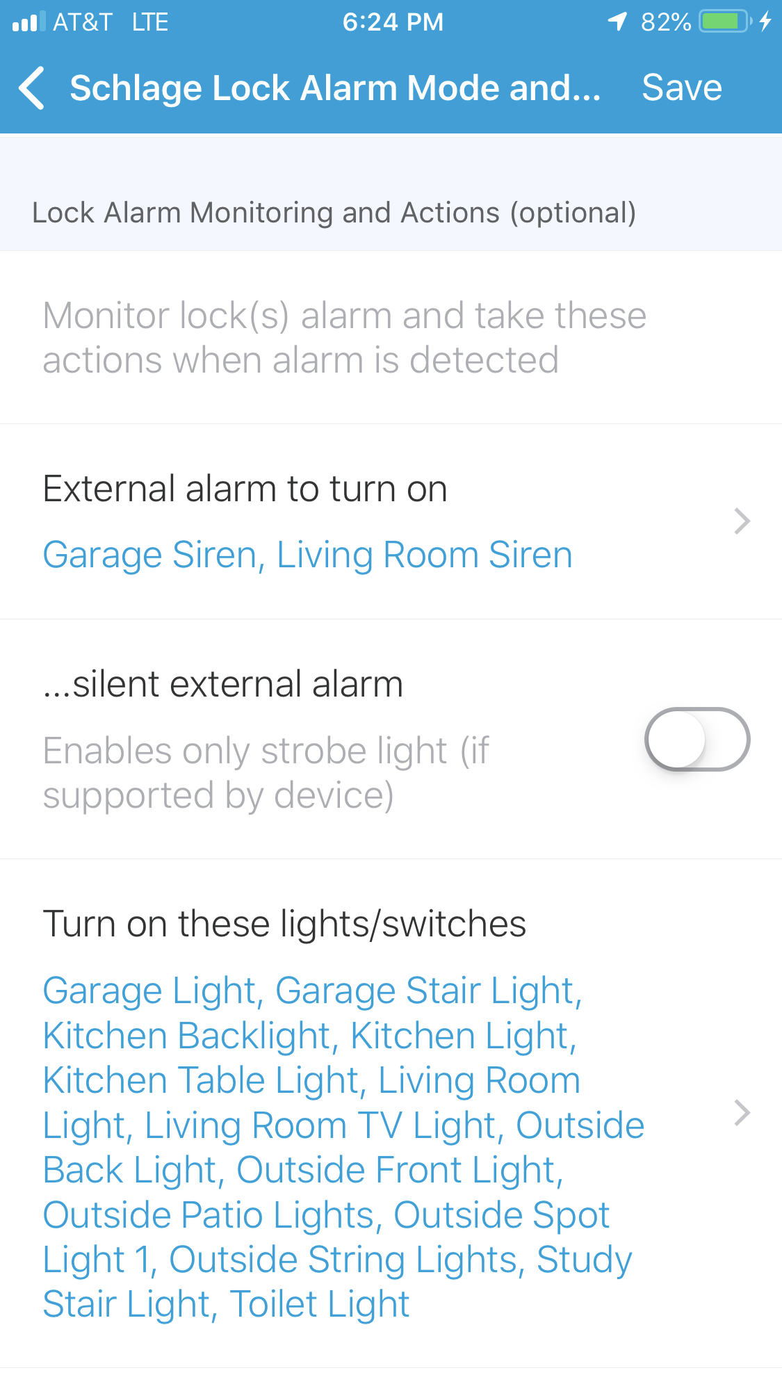

Yes it’s definitely possible, when using this Enhanced Z-Wave DH:
The lock will send a “Tamper” alert when the built in alarm is set off. You can then use this tamper alert to set off the alarm using SHM. If you want, you can also configured the DH send a “motion” alert in addition to a tamper alert since not all SmartApp support tamper alert devices but most of them support Motion alerts.
Here’s another app you may find useful to set off the siren when it detects tampering.
I have an identical setup with three Schlage and I use custom device handlers and smartapps to control them. If you aren’t using it now, I would highly recommend @Rboy because it simply works and his support is top notch almost to a fault. Don’t let the small fee he is asking stop you like it did me at first because you get access to his library of apps. One of my favorite features is being able to maintain one smartapp for the user codes that automatically syncs up all three plus any valid user code disarms the ST security function.

You can use RBoy’s custom device handler + smart app to turn on your own lights + sirens when the lock’s alarm is triggered:
