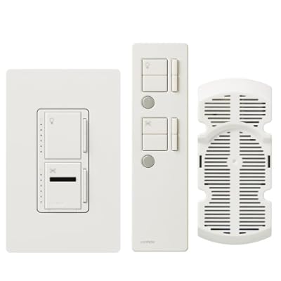

Another option for fan control, although it’s expensive, is to get the Lutron Maestro IR wall switch, which gives excellent fan and light kit control, and then control the switch with harmony.
Harmony runs on Wi-Fi and has an IFTTT channel, so that gives you IFTTT control of the fan.
This is a well engineered device, excellent ratings, it’s just that it’s expensive. $100 for the switch and another $100 for the harmony. And the switch is an IR device so you have to be line of sight to the harmony, you can’t use a harmony back in the main house.
