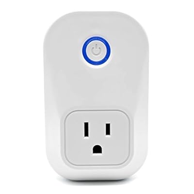

What about this device ?
Does it work with Smart Things ? It’s not listed in products that work with ST so maybe not.
