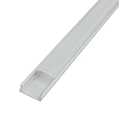

Take a look at these. It will help your install look better and the lighting looks more even.
Would you recommend these over the shallow channels? And does my “shopping cart” cover everything Id need?

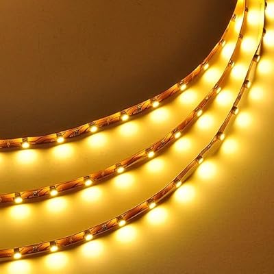

I dont want to buy the strips if theyre not BRIGHT. the wife wants light, not just accent lighting

I bought these lights, as well as some that are 3000k, along with these adapters.
When I built my house I had outlets wired in above my cabinets and ran from a switch. I also had lights wired in beneath the cabinets on a separate switch.
What I’ve done is, using the light channels, I built my own lamps. I built a set of the 2700k for accent lighting above and below the cabinets. The wires from the underneath lights runs discreetly up the inside corner of the cabinets, connects to the light above and plugs in the wall.
I built a second set of lights using the 3000k fit under cabinet work lighting. These took the place of the halogen lamps that were installed by the builder.
As for brightness…
The 2700k led’s required a total of 6 led’s on top and 9 on the bottom. They are a warm white and give a good glow. You can still work with them without turning in the others. They are great for looks and for getting a drink.
The 3000k are a more white light. I used a total of 15 led’s to make the very bright work lights on the bottom.
These rolls are able to be cut into 3 led sections. So, when I say I used 9 led’s, that’s means three sections. Also, I used telephone wire to connect between all of these. I cut them into sections to spread the light more evenly, and the diffuser helps as well.
If it’s not bright enough, just add more led’s. But these are very bright.

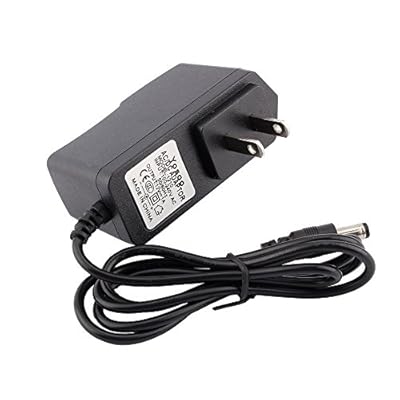

I didn’t see, maybe I missed it but did you get a 110V AC to 12V DC power supply in there?
Thanks @Navat604. After discussing it aloud with my father (for a sanity check) this morning, it was agreed upon to do just that.
@Benji, the LED kit came as a kit (remote, power supply, lights). Is that what you’re referring to?

Ah you got a kit, you should be okay then.
