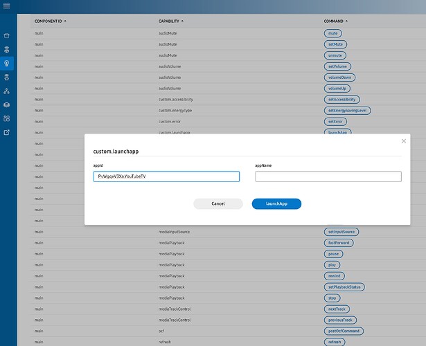

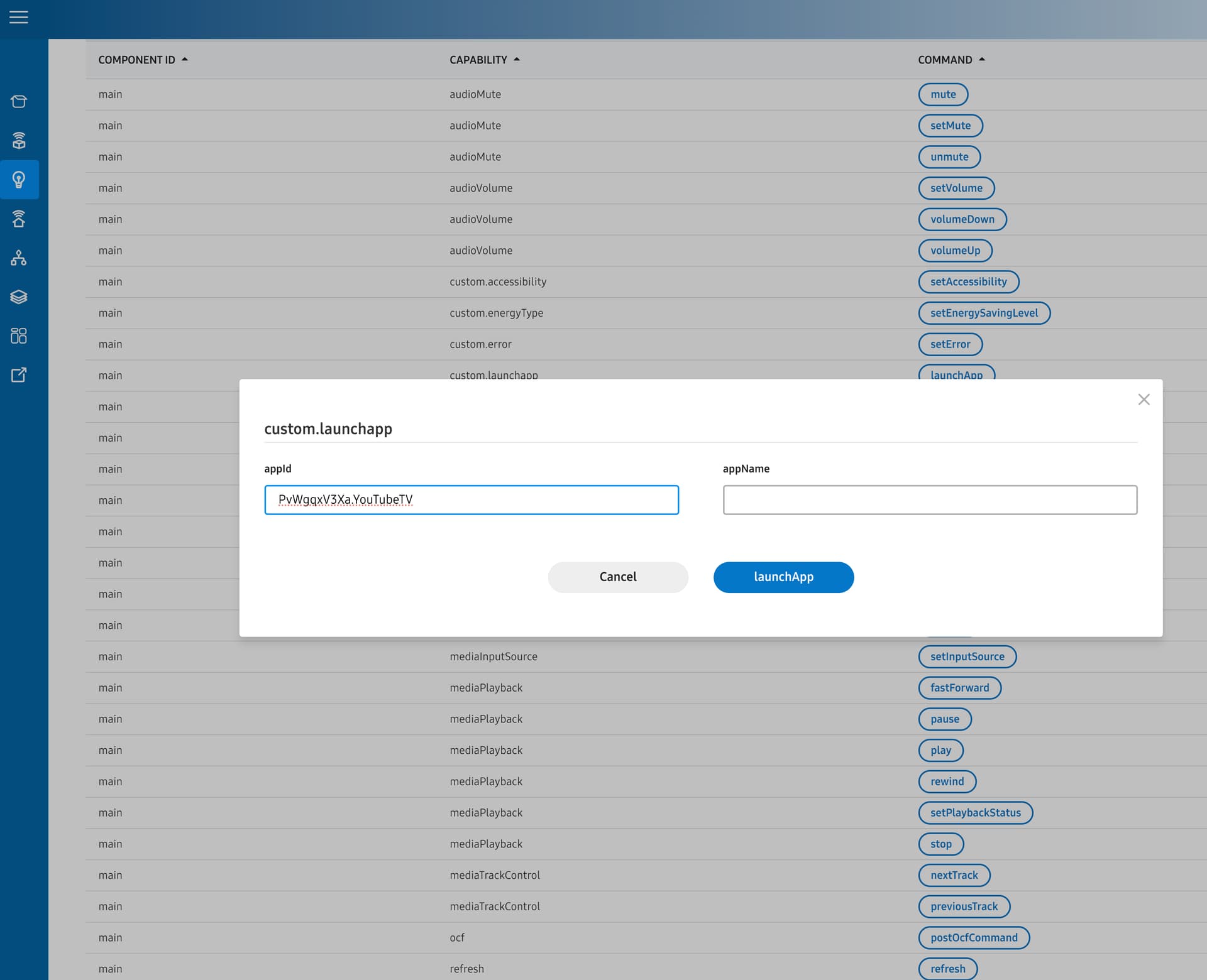

I am no longer really active with coding solutions on the SmartThings platform, so someone else will need to walk you through a possible rules API solution to watch for the “on” event of the device, but the POST command to issue to change to a Tizen based Samsung is:
{ "commands":[
          "component":"main",
          "capability":"custom.launchapp",
          "command":"launchApp",
          "arguments":["PvWgqxV3Xa.YouTubeTV"]
You can webpage test the solution here, and then input “PvWgqxV3Xa.YouTubeTV” in the command section of the device.
