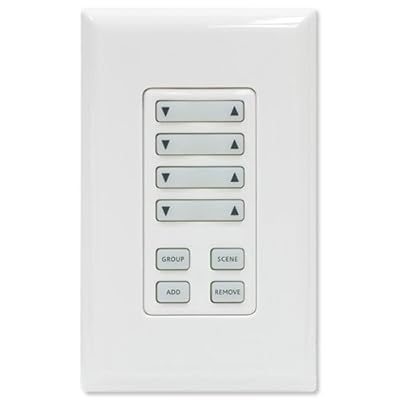

they are dumb bulbs connected by GE Z-Wave Wireless Lighting Control Lamp Module, thanks for the link, i am going to read it next. also sorry for repeat question. Also i was reading a light switch (link below) it says Secondary controller; requires primary controller (not included) - is the primary controller the smartthing hub?
The primary controller is the smart things hub, yes.
That particular device is what is called a “local scene controller” and it will only be able to work with other Z wave devices which are within one hop of it. So most people using SmartThings choose other similar devices which have more flexibility.
