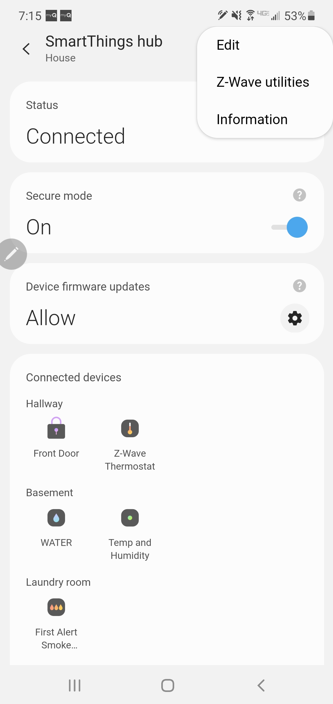

For those looking for the general exclusion.
Click on smart things hub, then the three dots in the upper right corner.
