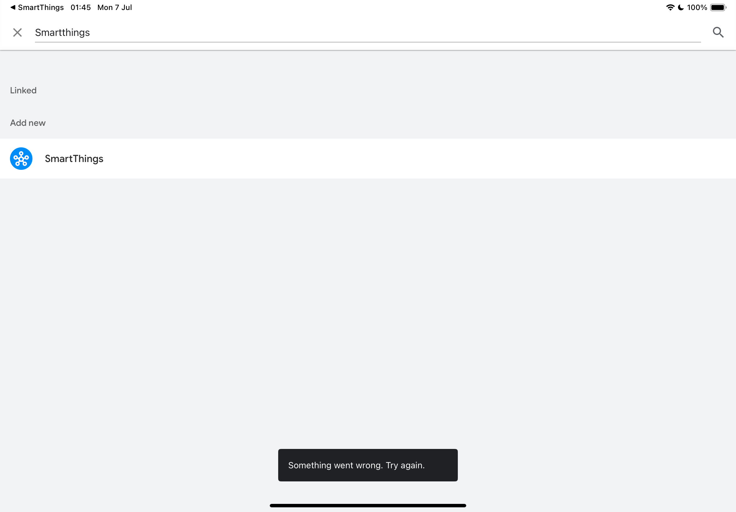

Currently linking ST to Google Assistant is not working for me.
I opened a ticket through the ST App.
Working now, random fix.
ST Support replied with standard how to, however they did ask me to login to samsung account at account.samsung.com which seems to have fixed the problem. Logged in to samsung account and received a message to reset account recovery security question which had expired. After that I tried linking smartthings to google assistant and it worked.
