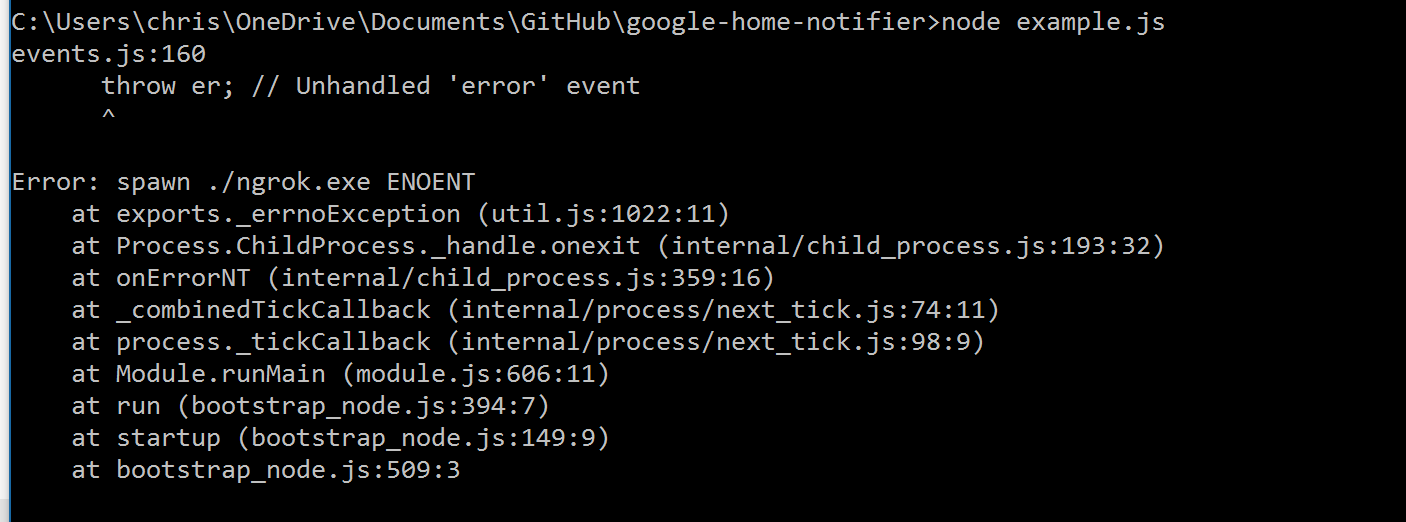

When I try to run the example.js I get an ngrok error. Never used ngrok, no idea what it is. I’m done for tonight, might try some more tomorrow.
