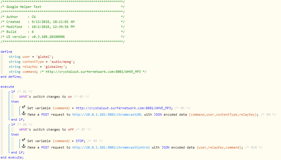

I’m still fighting with Webcore to get my test working.
I created a virtual switch to test starting and stopping a radio station.
Nothing plays, but it does get to the service:
https://pastebin.com/x7wYfTRd
There’s an error in the log: error: Invalid service name, aborting.
Do you have a Chromecast group named global? The name used for Chromecast casting should be the friendly name, which is what the group or device is listed as in the Google Home app. It’s not a special string defined by this server, or anything. If you look at the early part of the log after the service starts, the cast engine should log all the devices it has found and their friendly names.
Look for info: Found service.
Oh, and in case it wasn’t clear, the place to define the correct chromecastFriendlyName is in config.json. See the docs.
