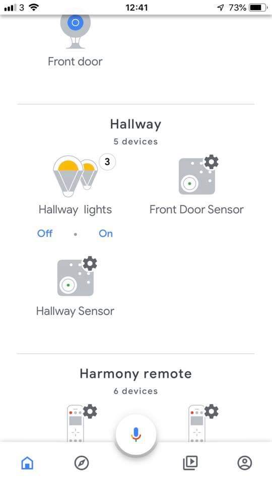

But for some reason all my Contact sensors and motion sensors don’t seem to be detected properly they do show as sensors in the list but don’t respond to anything like asking the status.

The Google Home app just presents a generic icon for a contact sensor and calls it a ‘sensor’. You can’t usefully interact with it in the Google Home app. Don’t know about the Home Hub. However you should be able to use voice or text commands though. Like ‘Is the name of device open?’. In the UK we are in the dark ages Google Home wise, but that does work.

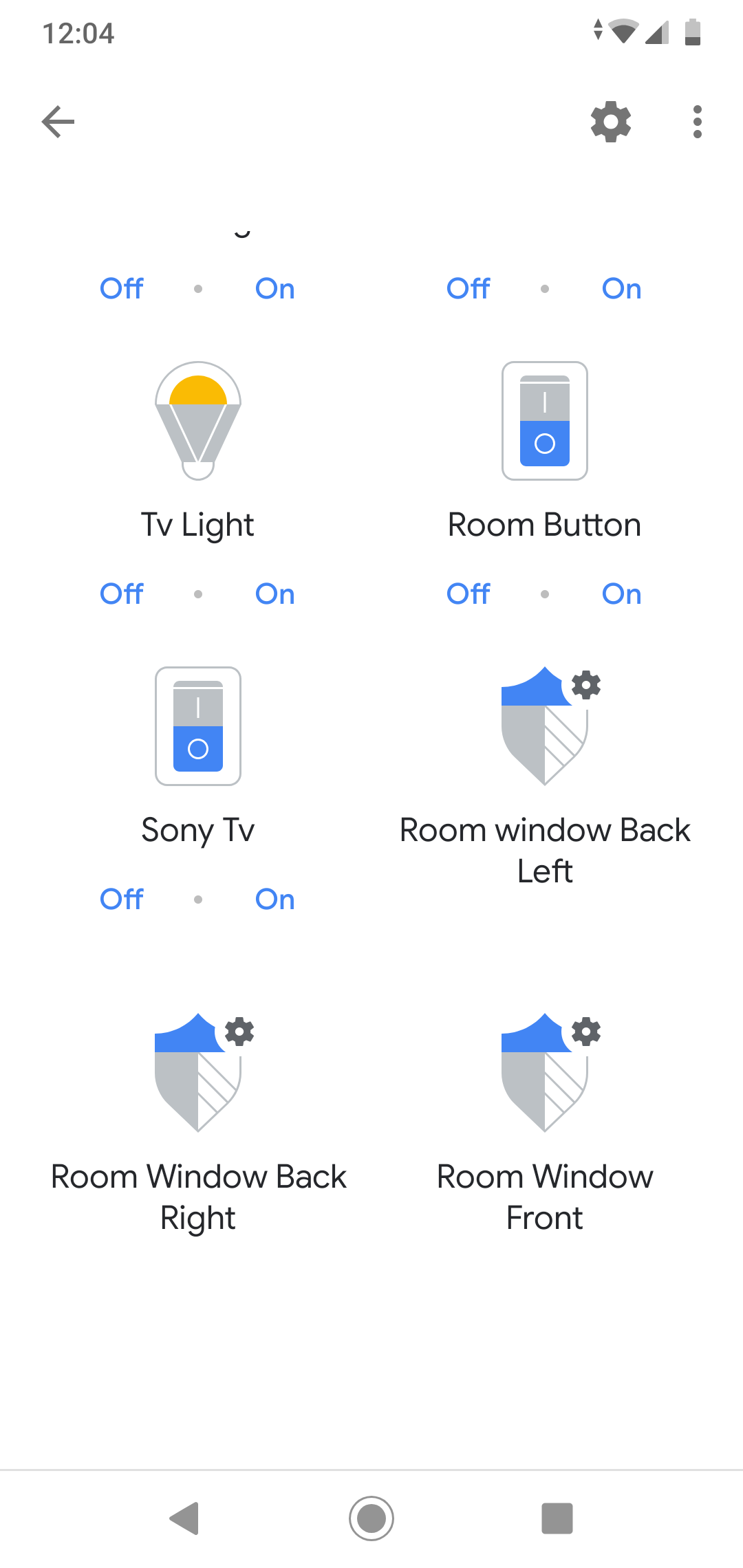

But he wasn’t able to sort my icons out as motion sensors and contact sensors both show a shield , but I’m not bothered about that.
Mine show as a shield too.
Yep, even then. I have a couple types and they are all the shield.
