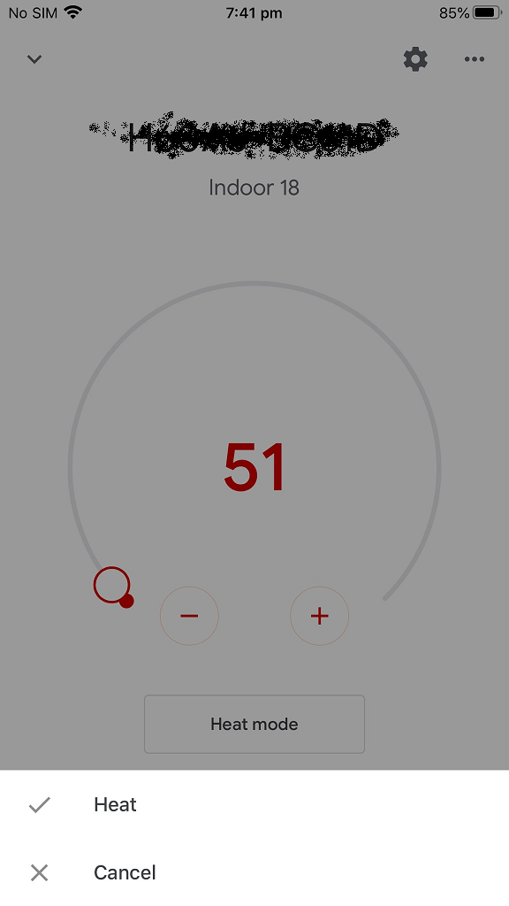

I am now trying to use Google Home App and added my SmartThings Thermostat device into the Google Home App and was added successfully.
However, our device could not successfully display the correct thermostat modes in Google Home App.
It only displays Heat mode and Cancel options, even though in SmartThings app, mode displays from [“auto”,“emergency heat”,“cool”,“heat”,“off”].

I see an option in SmartThings App menu about Google Home App settings when browsing SmartThings App->Settings Icon->Connected Services->(MyRoomName)->Google. In the settings page, when I turn off the switch “Allow Google Assistant to access all devices, Scenes, and Routines”, I see Thermostats option that is disabled and display No device found. May I know how can I enable this options with my SmartThings Schema connector-based Device? Attached screenshot is what I see in the SmartThings App Google settings.
I erased the device name for my privacy.
