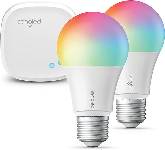

I went with this pair of bulbs so I can have 2 colors at least :slightly_smiling_face: The ST hub would of course be used instead of the packed-in one.
That looks like a good choice for your project. Have fun! :sunglasses:
