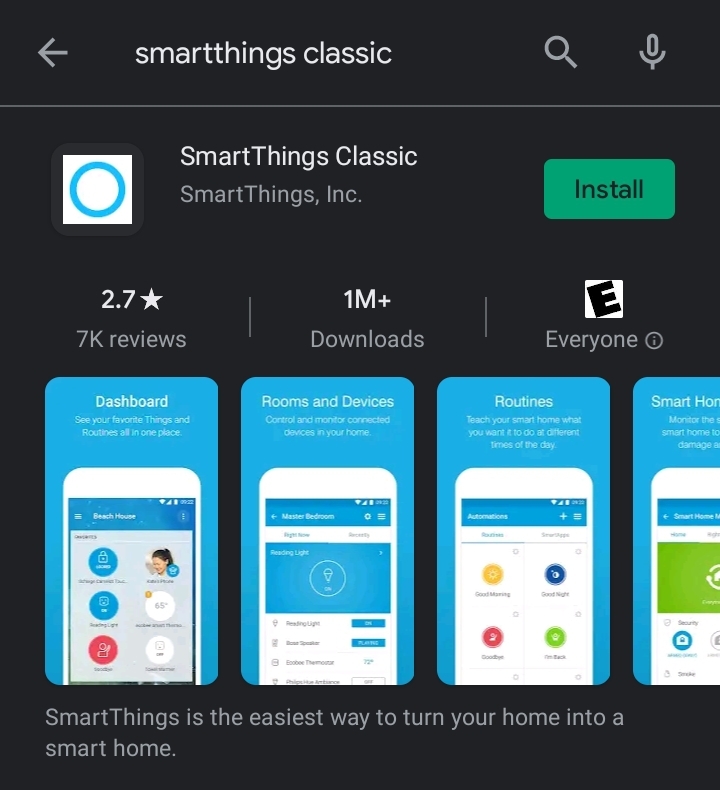

Get ready to make the switch!
“Enjoy it while it lasts”?
ICYMI, here’s that official statement
Thank you HalD
Yes, here
ah, they got smart and are taking the gentle kill approach. LOL
