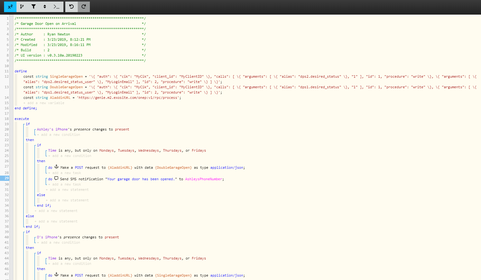

  2. For me, all I wanted out of this integration at the moment is to have my respective garage doors open when either my wife or I arrive at home using phone presence (if this works well I’ll get presence sensors for each vehicle). So I created a WebCore Piston which fires on our phone presence sensors and executes the open command on the respective garage door upon arrival using the following settings which will be explained in further detail:
  1. I created local variables in WebCoRE for the AladdinURL and DoubleGarageOpen using values from the SetDoorState segment of Postman. If you’re not familiar with local variables, you can create them by clicking the X^2 button at the top left of the piston editor screen in WebCore. Neither of these are required to be variables so you can actually enter them into the respective field as values instead of variables. Regardless, here is how I got them
  • The URL is: https://genie.m2.exosite.com/onep:v1/rpc/process
  • The Request body l copied from Postman after testing the open\close functionality worked. Here is the Postman screenshot, but it is VERY IMPORTANT to note that you will need to escape every { and } character in WebCore by changing them to \{ and \} otherwise WebCore can’t process the string correctly. Here is a screenshot of the Postman body used to test the open\close functionality. As noted in the Postman tutorial desired_status of 0 is closed, desired status of 1 is open :

  • If you have more than one garage door, dps1 is garage door 1, dps2 is garage door 2 and dps3 is garage door 3. Only 3 are supported on any one Aladdin Connect hub. Since I have 2 garage doors I had to use a different Request body for each door. dps1 and dps2 being the only differences.
  1. Here is a screenshot of the WebCore Piston I created for reference with MyCik, MyClientId, and MyEmail address needing to be replaced by your entries from Postman:
