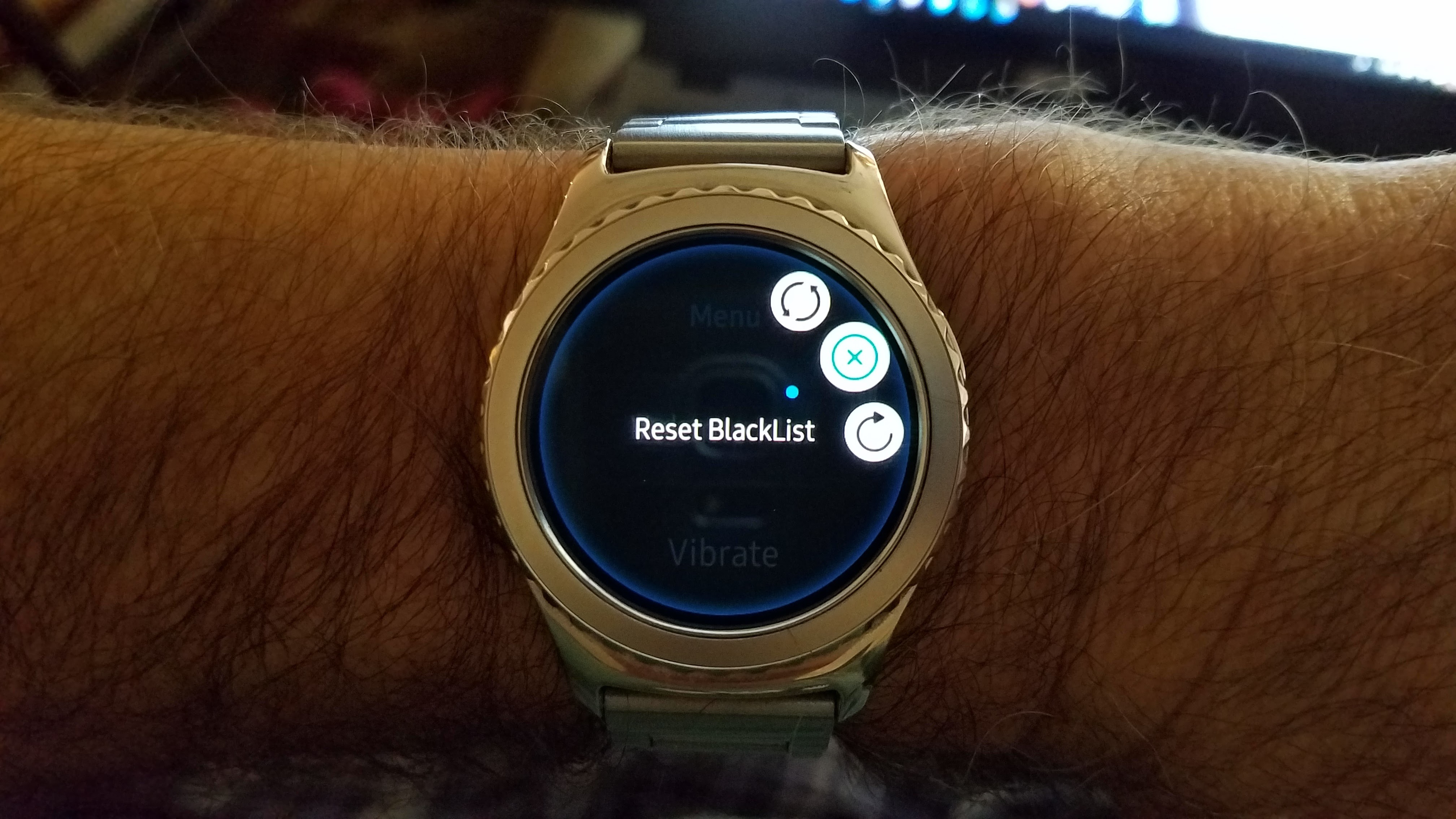

Enjoy…pic below is from the Gear app store page for the TaskS2 Gear watch app.
Pics of the app icon and screens on my watch:
