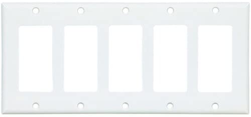

Is that the Leviton Decora wall plate? I’m looking at the Eaton wall plates on Amazon, but am unsure what is the correct size for the GE/Jasco switches.
Anything Decora is only one size. Just select how many gangs your box has. I’m using Leviton. GE/Jasco switches is like standard Decora switch, just a little deeper.
