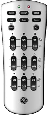

I found this very handy for testing zwave devices. Good for checking device health for join and remove.
