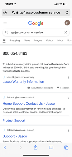

How old is the switch? GE/Jasco upped their warranty to 5 years recently and if you are within that window call them for a warranty replacement. A power outage caused two of my switches to start clicking and I got brand new Enbrighten switches as a result.
I appreciate the heads up! AND, sorry for the 30day late reply! BUT, I was a few months short of 5 years and Jasco replaced the plug without issue. I had to take it out and send them pics of the date code and my invoice, but a couple weeks later a new plug showed up.
Thanks guys! I have about 5 of the “clickers” all on/off that I’ve been meaning to replace but haven’t yet. Called CS and it was as simple as sending them a picture of the switch with the wall plate removed and them sending out replacements.
