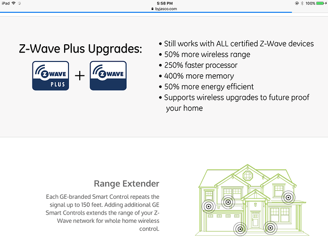

Yeah I don’t have one to measure and only have the manufactures claim on their site that it is 50% less power consumption than the originals. See this:
Half way down it says “50% more energy efficient”
Right, but that comment is just attached to the description of the Z wave plus chip itself.
It’s not telling is whether this particular light switch is any more Energy efficient than a previous model. Just that the chip is.
On top of that, “energy efficient” is not the same as “has a lower impact on your utility bill.” A device can be more energy efficient but still draw more watts than another device.
So you need to look for the actual draw.
