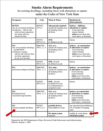

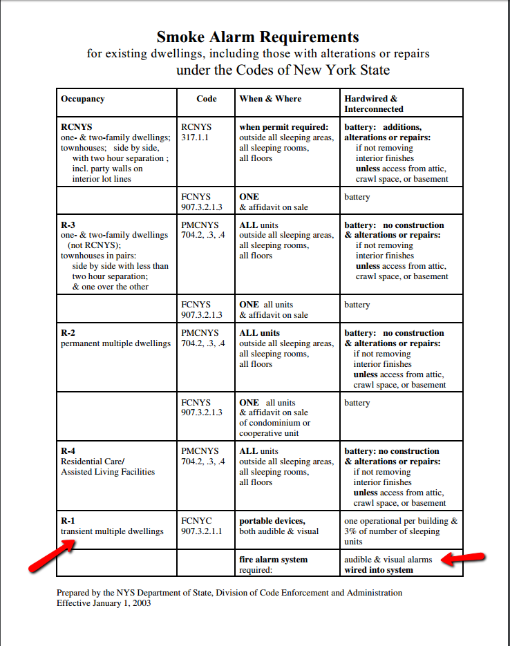

This might be completely wrong, this is from a 1 minute google search. I am in NY, it appears that the law states battery operated detector, except for Transient-Multiple Dwellings, and then they must be wired into system.
Page 4/ last page of this document
