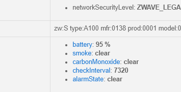

In drilling down into the device it shows carbonMonoxide clear as a state, which implies this device type handles smoke and carbon monoxide.

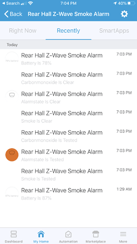

When I hold down the test button on the smoke detector this is what shows in the history. The app itself only shows alarm
I use to have these before going with the now defunct company - Halo (devices still work great), but if I remember right, you will see alerts specific to CO. There’s an old discussion in the community somewhere about this, and where a few of us had/have a CO tester can to test with. If I find it via a search, I’ll update my post with that link.
