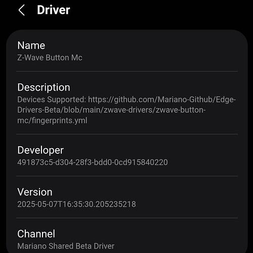

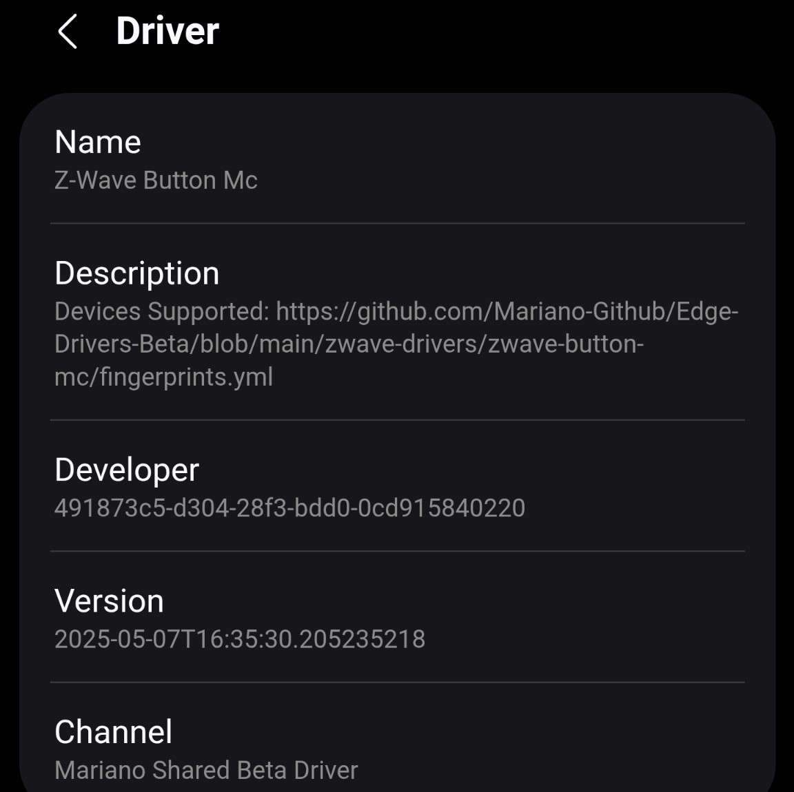

Well, swapped ST stock driver for @Mariano_Colmenarejo’s and all button combinations working consistently… swapping back to the ST driver and issue is re-introduced.
Just some details:
