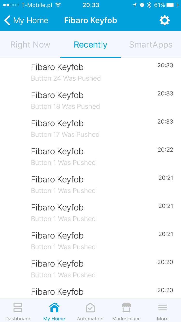

Right now I’ve got 24 buttons working (double, tipple presses as separate buttons etc). Only negative is that enabling double and triple presses introduces a 0.5 sec delay on first and second press (due to remote waiting for next press, as pointed out by Fibro manual).

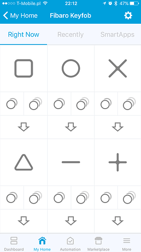

Button sequences also should work as soon as I program them into remote. You can have 6 of them (sequences of 2 to 5 buttons) for a total of 30 functions/buttons in 1 remote. I’m planning to make a separate tile for each one (and also custom icons because why the hell not) - DTH interface will look retarded :stuck_out_tongue:
I’m new to the platform so it takes me longer than it would someone more experienced. For example I spent some time wondering why they did not work in CORE until I noticed I selected off() insetead od on() for the relay I was using for testing :smiley:
I hope I will have something more to show tomorrow. Right now it looks like that:

Also because the remote sends both Held and Released events I implemented the “Hold” Function both as buttons and as Switches so you can easily use it for momentary light (on while holding, off after release) etc
For now I got 1 push and hold working.
