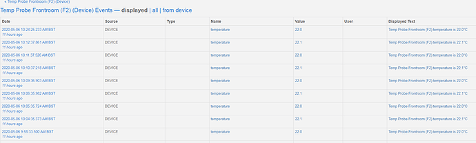

oops. again, a disconnect in the early hours, only solved after a power cycle this morning just after 7am. During the disconnect, all probes on the mid floor registered zero degrees (see following image, just showing the frontroom ds18b20):

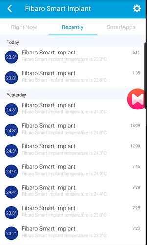

Here’s the implant in the app:

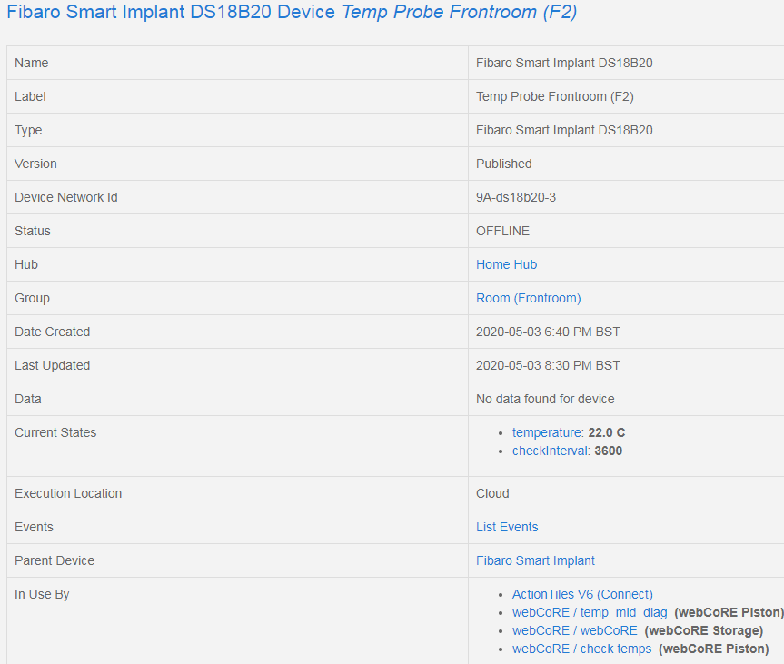

Here’s one of the sensors in the IDE:

From your screenshots it doesn’t look like it’s a z-wave connectivity issue. The main device is ONLINE and is receiving updates from the internal temp sensor and the probe device is OFFLINE. So, it’s either a software issue, or the implant is loosing connection with the probes.
