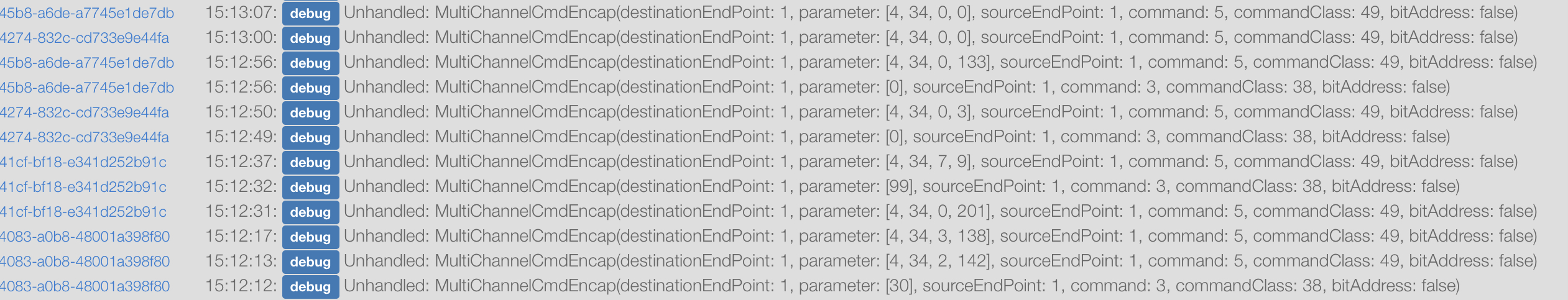

This is live logging from using my Dimmer 2:
02be600a-52e6-4083-a0b8-… 09:01:56: debug Unhandled: MultiChannelCmdEncap(destinationEndPoint: 1, parameter: [4, 34, 0, 0], sourceEndPoint: 1, command: 5, commandClass: 49, bitAddress: false)
02be600a-52e6-4083-a0b8-… 09:01:46: debug Unhandled: MultiChannelCmdEncap(destinationEndPoint: 1, parameter: [4, 34, 0, 99], sourceEndPoint: 1, command: 5, commandClass: 49, bitAddress: false)
02be600a-52e6-4083-a0b8-… 09:01:45: debug Unhandled: MultiChannelCmdEncap(destinationEndPoint: 1, parameter: [0], sourceEndPoint: 1, command: 3, commandClass: 38, bitAddress: false)
02be600a-52e6-4083-a0b8-… 09:01:34: debug Unhandled: MultiChannelCmdEncap(destinationEndPoint: 1, parameter: [4, 34, 0, 204], sourceEndPoint: 1, command: 5, commandClass: 49, bitAddress: false)
02be600a-52e6-4083-a0b8-… 09:01:30: debug Unhandled: MultiChannelCmdEncap(destinationEndPoint: 1, parameter: [4, 34, 0, 221], sourceEndPoint: 1, command: 5, commandClass: 49, bitAddress: false)
02be600a-52e6-4083-a0b8-… 09:01:29: debug Unhandled: MultiChannelCmdEncap(destinationEndPoint: 1, parameter: [3], sourceEndPoint: 1, command: 3, commandClass: 38, bitAddress: false)

Just a quick comment to the above posted logs.
The device sends a message from endpoint 1, that is unhandled in the DH, as it expects messages only from endpoint 0.
If you could describe how you set up the Switch / Dimmer, where is your physical switch connected, etc. That might would help the developer at ST to investigate why the heck are those devices sending messages from endpoint 1.

They all report the same errors while triggered from the ST app:
However, while triggering them from the physical S1 switch, I do not get any error messages in the Live Log. No messages at all actually. Same thing when triggering scenes using the S2 switch on the three Dimmers connected using double switch - no error logs, and scenes executed successfully.

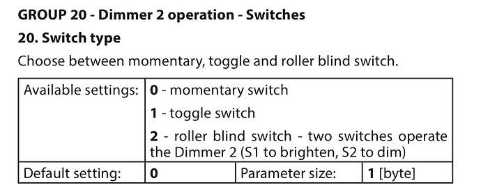

What kind of switch are you using? Momentary? Toggle? Rocket? (It is also called roller blind controller.)
What S1 is programmed for? What S2 is programmed for?
What method have you used to adjust the parameters? Zwave Device Tweaker?

S2 is a scene controller in the 3 devices using the S2. S2 is not connected (physically) not used for anything in the one configured witha single button. All four experience the issue, so it seems (to me) un-related to the scene configuration.
S1 is not programmed. It simply triggers the on/off/dimming of the connectedd lights (default mode).
The parameters looks like this (only change made is to activate scene in 3 out of the 4 dimmers):
Parameters were adjusted through ST web interface (above interface). But only for 3 dimmers as stated above. 4th remain untouched to this date - still with the same issues though.
Switch type is (as seen above) default on all dimmers, which equates to “momentary switch”:
And they are all connected to momentary switches from Elko (Plus).
Let me know if you need anything else!
