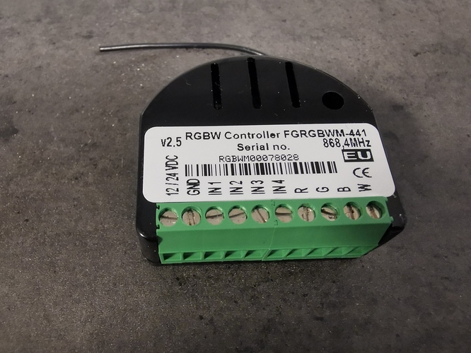

A side note: according to Fibaro, the controllers come with different firmware versions, which can only be updated through the Fibaro hub. So different firmware versions could explain why some controllers handlers work for some users, and others not… Also there are two generations of controllers: FGRGBWM-441 and the newer FGRGBW-442. I have the first one.

How can I verify the exact model I have for the FGRGBW?

I was able to find my model from the boxes that they came in and they all seem to be 442. However, I am not able to see the firmware version unless it is the v5.0 that I see in print.

Well they look quite similar but the label on the back should state the exact model name.
