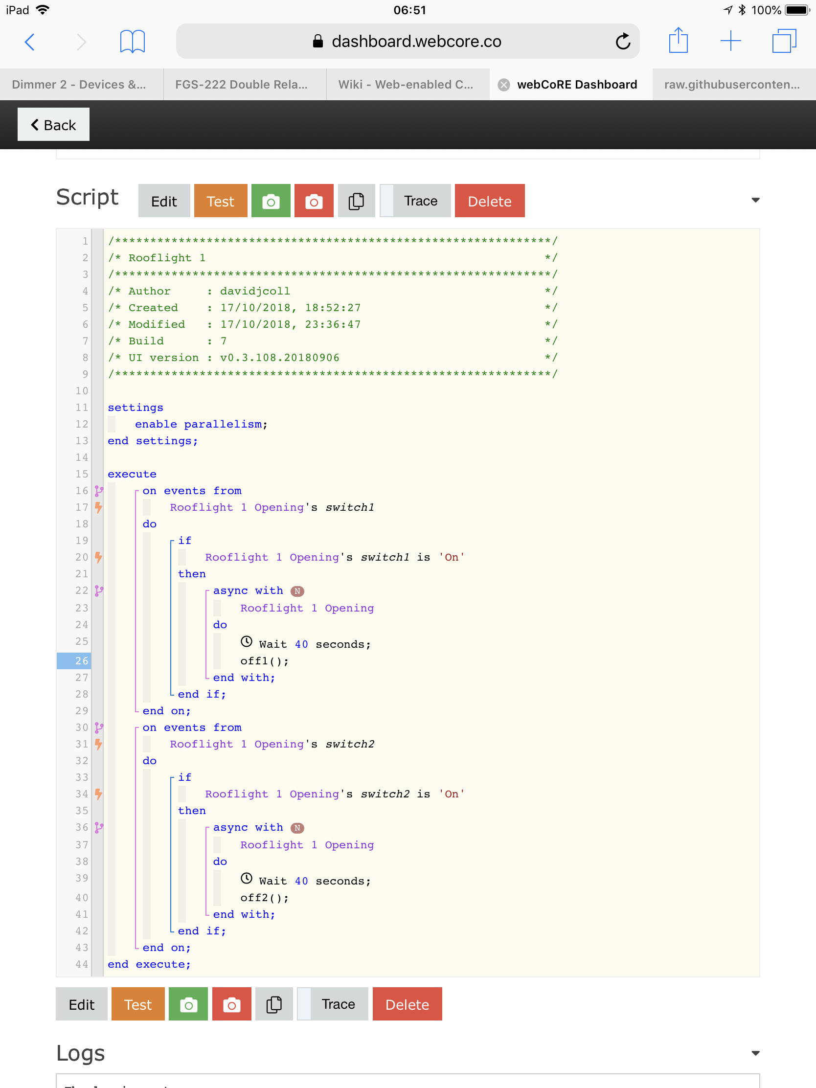

I’ve added parallelism, but unfortunately Switch 1 and Switch 2 don’t turn off after 40 seconds (they don’t turn off at all). Probably just needs a tweak somewhere.
Here is my latest WebCore coding:
Fixed it! Seems it was case sensitive. I had ‘On’ with a capital ‘O’. Changing it to ‘on’ has done the trick. It turns off after 40 seconds. Thanks!

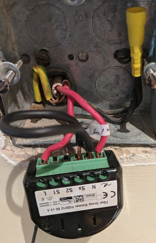

I’ve just reinstalled a Fib Dimmer 2 thats been hanging around. Not bothered with switch so connected common to the output (squiggly line) and Live to L. I’m contolling 12 x 3w LED’s . I can dim but they suddenly go off. I think its a voltage issue. Any ideas?
Do you have a bypass module installed? Typically required if the total load is less than 50W.
Alternatively, it could be the bulbs themselves.
No Bypass would be just under 50W as well. Cant get into the ceiling to fit bypass, I believe you need to get to neutral. Is it poss to fit at the switch for a no-neutral (UK) fit?
Thanks for that tip but it came back “Load Fault”. Is there a fix?
Sorry just checked they’re actually NOT Led’s they are 30w (I think) incandescent standard bulbs. Is my wiring correct (I’m not using a switch
Just straight into module) - common to the output (squiggly line) and Live to L?
Ok, Ive taken half out so now 180w Ive put the loop in and still get overloaded.

Yes I appreciate trim the copper. It was merely for a test. The permanently Live (Via a tester) is in “L” The other cable (switched live) is into the output (switched live). Ive tried them the other way around and the result is identical. I have tried with one bulb only and separately with a few LED’s in. Each time doing the re-calibration and each time with the same Overload error. Could the unit be faulty perhaps?

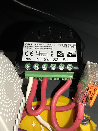

LED strips upwards to 50W run by a dimmable quality LED Driver supporting dimming by both leading and trailing. LEDs are 12V. I installed it by a 2 wire config, see pic attached. I had to manually config the load type from trailing to leading to avoid “Surge error”. But now I get “Voltage error” instead. I switched from Nano Dimmer due to flicker but now I run into a totally different issue (flicker is gone with Fibaro).
If you have any tips I’ll be super happy.
Yes the white wire goes straight to the 230v-12v driver which the strip is connected to. All was connected before calibration.
