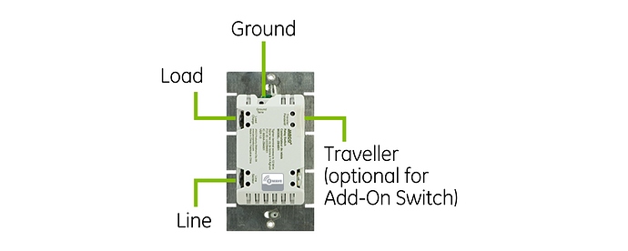

2) GE 14299. Zwave plus. Works with incandescents or halogens, but not LEDs. (it’s a physics thing)
https://www.amazon.com/GE-Enbrighten-Incandescent-SmartThings-14299/dp/B07361Y54Z/

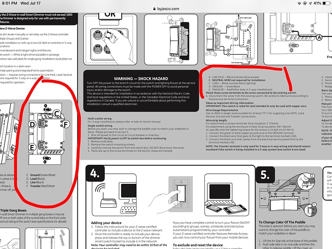

Amazon page says " * Neutral wire is required. Includes white and light almond paddles (wall plate not included)"
Yeah, I know, but that’s wrong. It’s copied from the product description for another switch. Look at the manual and the wiring diagrams: “neutral wire not required“ and there’s no neutral on the wiring diagrams. You can confirm this with Jasco support.
https://byjasco.com/sites/default/files/product/manuals/12725%20EnFrSp%20QSG%20v1.1.pdf
Most of the current generation GE Z wave switches do require a neutral, but that specific one, 12725, does not. Which is why it doesn’t work with LEDs.
The new model, 14299, is described correctly, so I have fixed the Amazon link above to go to that one.
