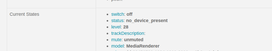

Nope, dang it, not solved.
Came back home and speaker was still showing “no present.”
Removed it from SmartThings, added it back in (that works OK), found it w/the Media Renderer Smartapp and selected it.
Back to My Home screen in app and it still shows “no present.”
In the IDE device page same info - switch off, no device present.
The Fabriq app shows the device online and I can play music on the speaker from the Fabriq app, and I can see the device on my network in my router management pages. Everyone says it’s there and ready to go except SmartThings! <eek!>
Any ideas?
