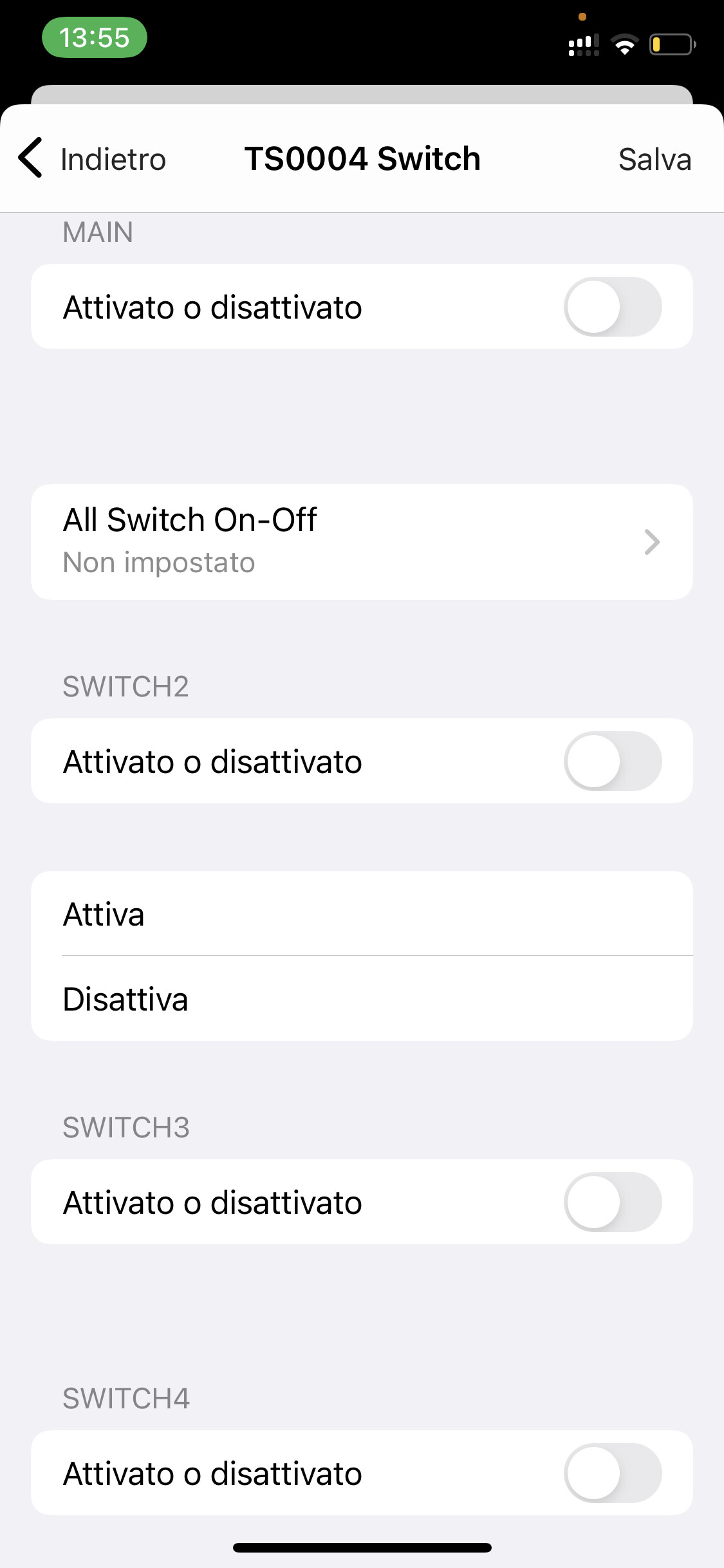

maybe I have not explained myself well (my english fault) I am trying to install a new 4-channel zigbee and another 2-channel, but when I do the search they are detected as a single switch.the 2-channel one and the loratap (see photo)

Looks like this, with device named, accordingly, at the top of the screen cap.
'Main" controls one of the two switches, while “Switch2” contols the other… “Switch1” will turn on or off both simultaneously.
The one from the cap is using Mariano Colmenarejo’s Zigbee Switch Edge driver from his beta driver channel. Things may have been updated since. I need to do some updating and testing of a few devices, but, as it is, this one is working well, as described.
