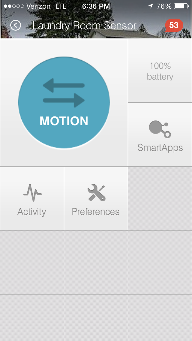

Thanks for the reply! This is weird. I excluded and re-paired with the dip switches like yours and placed the sensor in a drawer for a half hour. It never shows anything but constant motion:

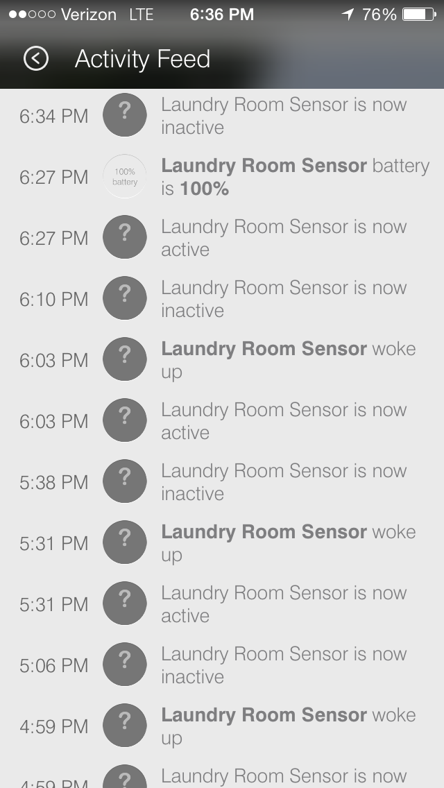

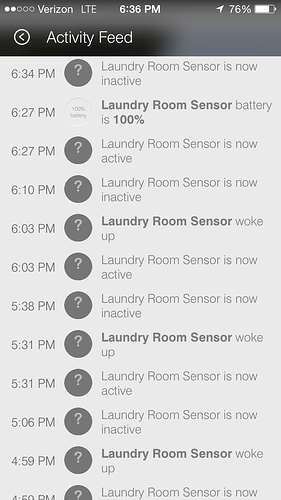

The activity log shows the following:

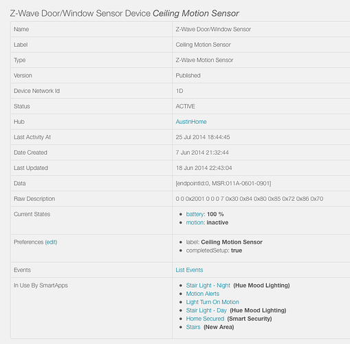

Finally here is what my device settings are:
Wondering if your settings look similar and what your activity log looks like? Maybe if I got a bum unit?
try changing the device type to a door or switch sensor, then changing it back. On your screenshot of the device settings it didn’t look like the status for ‘motion’ was being displayed. Also, my activity log for it doesn’t say ‘woke up’ when there’s motion sensed. it just says ‘detected motion’…plus the ? mark leads me to think it isn’t communicating properly(wrong device type).
