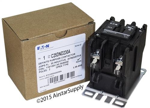

Hmmm, you could get any number of standard zwave switches and have that output control a standard contactor.
or whatever contactor makes sense for your use case, I just guessed at this one.
