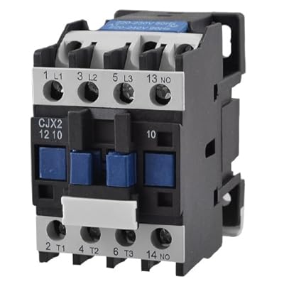

Not getting too technical - but you can always use a high voltage contactor and then use the micro switch as a relay (If you are unsure, would be 99% safer technically)
Which means buy an Aeon Microswitch:
Then buy a contactor:
Then this is how the contactor is wired, using the Aeon as the ‘120v’ relay:
That should do it… the new second gen Aeon handles up to 220v but does not have a 3 pole capacity for high amperage.

I’d agree with Austen, doing it this way will save you money later on if/when the relay fails (usually burned contacts). From my experience high voltage contactors fail much more frequently than low voltage ones.
