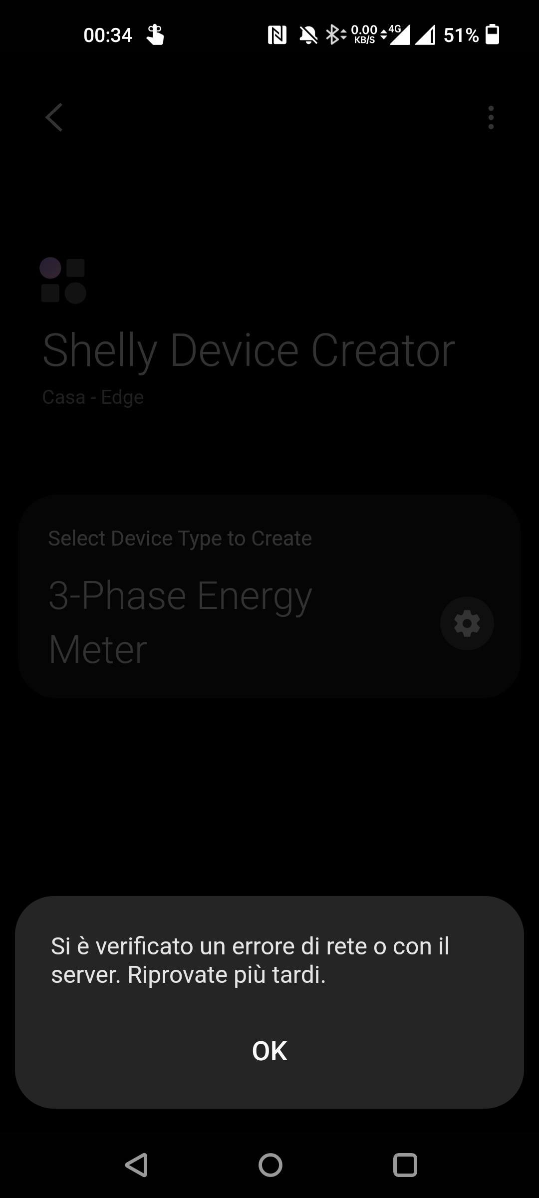

I can’t add it because the device creator isn’t working for me
That’s odd; give it some time and try again later. It looks like it’s not picking up the updated device selection list (there’s a new one with this update)
The strange thing is that before upgrading from the device β€œshelly maker” I could choose what to create. Now I see only β€œconnected” I will wait until tomorrow, maybe my hub has yet to receive the update :man_shrugging:t2:
Now it works, or rather, I can choose 3em,but not works
If I can do something to help you understand what is the problem, Let me know
If it doesn’t clear itself after a while, you may need to uninstall and reinstall the driver. Keep me posted. I’d be interested if others are seeing something similar.

An you try to create a 3EM?
Nope only shelly 1,
Just try to create a shelly 3 and i have a
network error , also try shelly 1 network error.
We’ll that’s discouraging! Let’s wait 12 hours. If it still is doing the same thing, it may be necessary to delete and reinstall the driver.
I’m really not sure why this would be happening. :thinking:

It is not necessary, from the device β€œshelly creator” I changed drivers using the web requesr always yours, I saved and put back the correct drive, so I solved and now the devices can still be added. I added the shelly 3 EM, although the many data indicated, make me very confused and I think it does not work properly. It’s still a good starting point :+1: thanks for your work
