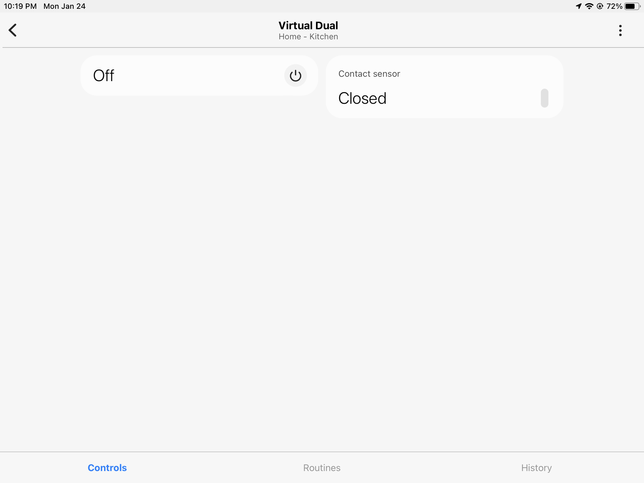

This is change icon:
Originally there was a door sensor, I did not like it, I changed the icon with a switch.
After I read that maybe making it appear a contact sensor, is something wanted specifically to use with alexa automations. Sorry if so, I do not use it, I hadn’t thought about it.
In the original community-created virtual (Groovy) switch/sensor from bjPierron, The “off“ and “closed“ were considered the resting states so those were equivalent (like a sensor on a door) so on equalled open.
This may have been because one of the original very popular use cases with a physical sensor was door opens, Alexa plays chimes. So you turn the switch on in order to set the sensor to open. So that may be what people are used to.
I think you only need to consider how the capabilities are presented. ‘On’ and ‘Open’ are considered the active states of switches and contacts.
Interesting perspectives about the relationship of switch and contact. Here was my logic:
These are relay devices. When a relay is turned ‘on’ or ‘energized’ its contact closes and power output is ‘on’. When a relay is turned ‘off’ or ‘de-energized’, its contact opens and power output is ‘off’.
Now I know some relays can be programmed or configured to behave differently, but this is the conventional operation. So to me, it’s counter-intuitive to equate ‘on’ to an ‘open’ contact, even though that may be the way SmartThings defined their capability presentation.
Maybe the net of all this is that I should add a configurable device setting to flip the relationship between switch and contact.

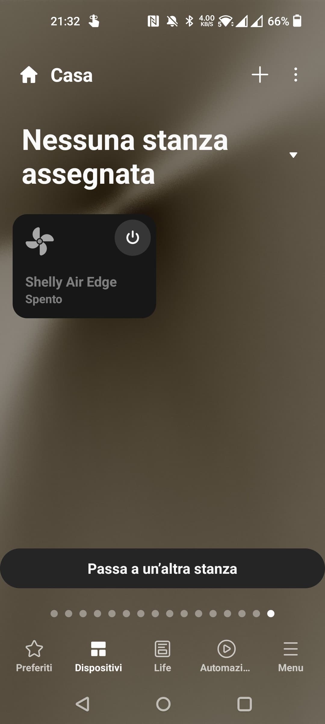

Thank you!! I don’t have any other edge or DH drives looking for Shellys in my network, I was talking about shelly’s native, cloud-based integration. When I add this integration, all devices are found and added. If I delete one, then he returns, because he finds it and adds it. I would gladly do without shelly cloud integration, but my shelly 3em is shelly Air they need that to work, unless you create an edge drive for them but I don’t think it’s worth it.
I don’t think many users have 3em shelly and even less shelly Air
Edit: shelly Air work with Shelly1PM device selected.
Only problem for me is shelly 3em, if I solve it, I can Leaving the cloud
Someone else has asked for the 3eM, so it is on my to-do list! I am not finding any info on Shelly “Air”; can you point me to which product that is please?
It’s a WiFi air cleaner.
https://shelly.cloud/knowledge-base/devices/shelly-air/
Thanks; unfortunately it is not even listed as a product supported in the HTTP API documentation, so it may only have control via Shelly’s own cloud. I’ll keep looking…

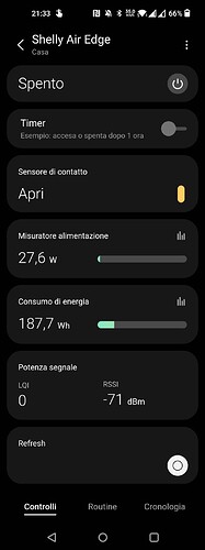

Can you try to reach your Shelly Air via a browser? Just type in its IP address and see if you get a web page coming up. Then if that works, try these endpoints:
192.168.1.xxx/status
192.168.1.xxx/settings/actions
Yes work. :+1:
Log: 192.168.1.xxx/status
{“wifi_sta”:{“connected”:true,“ssid”:“Campyhome”,“ip”:“192.168.1.21”,“rssi”:-68},“cloud”:{“enabled”:true,“connected”:true},“mqtt”:{“connected”:false},“time”:“00:07”,“unixtime”:1643324836,“serial”:2727,“has_update”:false,“mac”:“68C63AFAF5A4”,“cfg_changed_cnt”:2,“actions_stats”:{“skipped”:0},“relays”:[{“ison”:false,“has_timer”:false,“timer_started”:0,“timer_duration”:0,“timer_remaining”:0,“overpower”:false,“source”:“http”}],“meters”:[{“power”:0.00,“overpower”:0.00,“is_valid”:true,“timestamp”:1643328436,“counters”:[0.000, 0.000, 0.000],“total”:11289}],“inputs”:[{“input”:0,“event”:"",“event_cnt”:0}],“temperature”:34.37,“overtemperature”:false,“tmp”:{“tC”:34.37,“tF”:93.86, “is_valid”:true},“total_work_time”:7085491,“ext_sensors”:{“temperature_unit”:“C”},“ext_temperature”:{“0”:{“hwID”:“28fef43a2c1901ba”,“tC”:18.38,“tF”:65.08}},“ext_humidity”:{},“update”:{“status”:“idle”,“has_update”:false,“new_version”:“20211109-130841/v1.11.7-g682a0db”,“old_version”:“20211109-130841/v1.11.7-g682a0db”},“ram_total”:50744,“ram_free”:38028,“fs_size”:233681,“fs_free”:144576,“uptime”:121391}
Log 192.168.1.xxx/settings/actions
{“actions”:{“btn_on_url”:[{“index”:0,“urls”:,“enabled”:false}],“btn_off_url”:[{“index”:0,“urls”:,“enabled”:false}],“longpush_url”:[{“index”:0,“urls”:,“enabled”:false}],“shortpush_url”:[{“index”:0,“urls”:,“enabled”:false}],“out_on_url”:[{“index”:0,“urls”:[“http://192.168.1.2:37801/a5a37203-7284-4f0b-a2c1-7d1e19e4011b/relay/0/on"],“enabled”:true}],“out_off_url”:[{“index”:0,“urls”:[“http://192.168.1.2:37801/a5a37203-7284-4f0b-a2c1-7d1e19e4011b/relay/0/off”],"enabled”:true}]}}
Great! That means we have hope. Looks like you have something running on your LAN at 192.168.1.2 that is getting updates from this device already.
From what I can see it supports the following:
  • on/off
  • power meter
  • temperature
