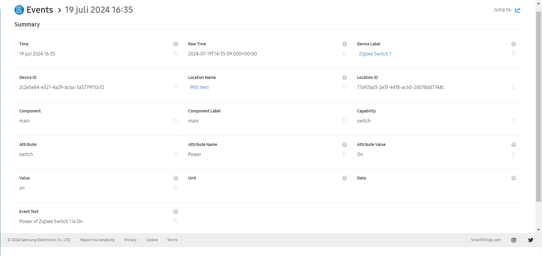

I think you are referring to this device:
model: 'SR-ZG9023A-EU',
vendor: 'Sunricher',
Please provide more information regarding Cluster and End Point in use. please connect your device to ST using @Mariano_Colmenarejo Zigbee Thing MC and send a screenshot of the device Finger print. It should be appear in the History tab.
Thx for your time and respons.
Done as suggested.
Can not fin muck new info
Maybe I am not looking in the right place.
Please advice
//Tommy
