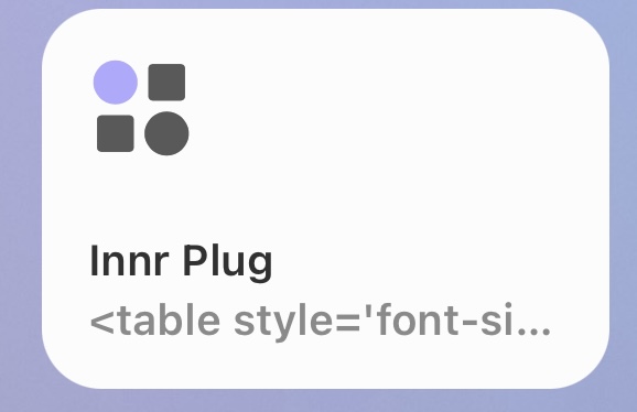

Another device request please, the new Innr SP 242 (Zigbee plug with power monitoring).
From Zigbee Thing MC I only get these:
IMG_2104
Using the ST webapp I copied the data, and think these might be what you need?
Manufacturer: innr
Model: SP 242
EndPoint.Id: 0x01
App Version: 0x14
ZCL Version: 0x08
Network ID: 0x6429
Server Cluster: Ep: 0x01={ 0000,0003,0004,0005,0006,0008,1000, 0702,0B04,E001 }
Client Clusters: Ep: 0x01={ 000A,0019 Ep: 0xF2={ 0021 }
I take note of the request, until Monday I will not be able to do it
