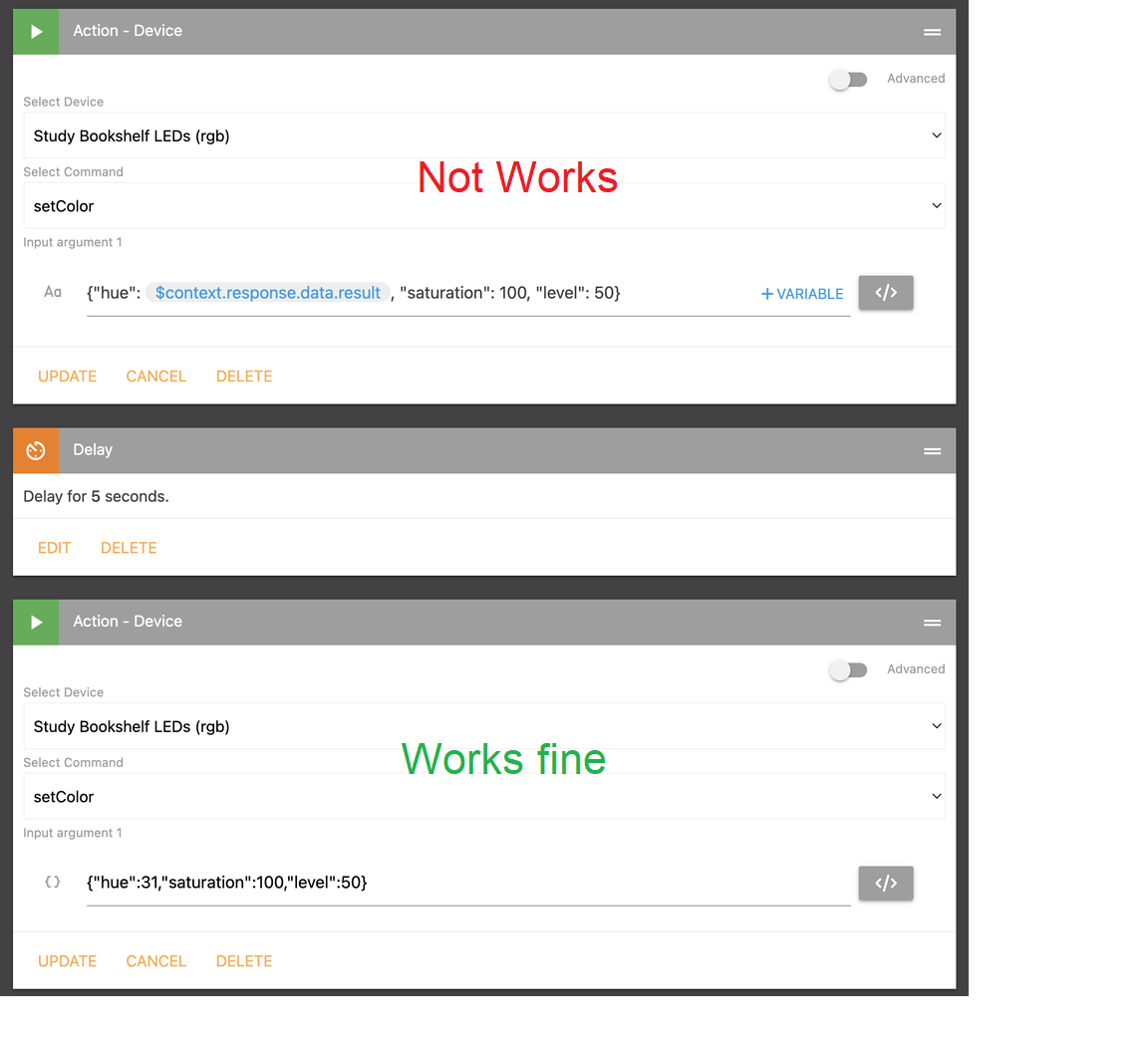

I don’t know how sharpTools handles the build of its automations internally, but the command that has to receive the driver, for zigbee device, has this format captured with the CLI. I do not have zwave bulbs, but de command had the same arguments: hue, saturation or hue + saturation depend of the command used: setHue, setSaturation or SetColor

On the other hand I see that in the setColor command of the sharpTools automation screenshot you send hue, saturation and level and this is not compatible with the setColor command.
The driver has to receive a setColor command with hue and saturation values and another command setLevel with the level value.

What he’s saying is that SharpTools can either send the arguments across as a JSON object or a string formatted as a JSON object.
JSON Object (standard)
{"hue": 30, "saturation": 100}
String with JSON
'{"hue": 30, "saturation": 100}'

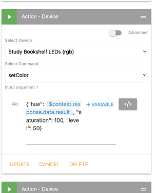

With other first-party SmartThings integrations I tested, they supported both formats. I originally suspected that the SmartThings REST API was doing the conversion of a string formatted as JSON to an object, but when @nezmo mentioned that it didn’t work with this driver, it had me questioning things.
The reason this is important to Nezmo is that SharpTools rules can use Variables in strings, but they can’t currently be used in objects. This let’s him create neat rules that can use random colors or other cool things with SharpTools variables.
It’s on my hit list to look at supporting variables in objects within SharpTools, but I won’t be able to get to it right away.
As such, we figured we would ask you if you had encountered this before and knew why the SmartThings first party devices handled the object encoded in a string whereas this driver didn’t. :smiley:
I don’t see that the problem here is the format in which the command is sent. String with JSON or JSON Object (standard)
I think the problem, from what I see in the screenshots, is that the hue value that is sent in the command is not correct.
When a numerical value between 0 and 100 is sent it works and when the result of a calculation is sent, as a variable it does not work

The result of the pickRandom([0,31,67]) is one of those three numerical values.
But he can only use that returned result in a String which has JSON encoded in it. The encoded JSON within the string is correct and has the numerical value in it.
The problem is the string with JSON encoded doesn’t work in the setColor() command in this driver. (He is using this same concept with another device)
If he skips the random number part and hard codes the hue value, it works in a JSON argument type, but not in a string that includes a JSON object within it.
SharpTools doesn’t currently support variables in the JSON objects which is why he was trying the string formatted JSON which has worked with some other drivers. It’s on my hit list, but not something I will be able to get to right away.

Effectively the command with the level argument is received but the driver does not execute it.
Execute a command On and level 100% which would be the last one used
When you send the command that does not works if nothing is received in the driver, it could be blocked in the API and does not reach the hub
Hi @Nezmo
Are you try send the command as @joshua_lyon says?
String with JSON
'{"hue": $context.response.data.result, "saturation": 100}'
I will need @joshua_lyon to confirm, but when I send as a string with JSON the SharpTools log entries show the following:
Sending device command: {{device@samsung-smartthings:b323d184-74e9-46c6-aaf1-ec444d86c17b:c5786932-377b-4657-be95-19313c95bc76:rgb}} β–Έ setColor({"hue":31,"saturation":100,"level":50})
Yes, that’s the String with JSON format.
The β€˜input’ format in SharpTools has the context variable as you showed @Mariano_Colmenarejo – that’s what @nezmo sees when he configures things in SharpTools, but it gets converted and sent across as a normal numeric value to SmartThings (within the string containing formatted JSON).
SmartThings has no idea that it came from a SharpTools variable - it should look like any other string with JSON content.

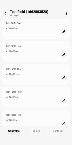

Install the Virtual Appliances Mc driver and create a TextField virtual device with 5 free text fields.
And send the variable with the value hue to one of these text fields, for example to the command setTextFieldOne and so I can see what arrives at the Virtual Appliances Mc driver
Okay, I’ll try this today when I get chance.
Installed the Appliances driver and submitted the same string command from SharpTools. Text was updated on the ST device. Here’s the CLI log:
2022-09-10T16:17:39.708382553+00:00 TRACE Virtual Appliances Mc  Received event with handler capability
2022-09-10T16:17:39.715600344+00:00 INFO Virtual Appliances Mc  <Device: f87b7d2d-5b1a-4881-a9ee-079aaa7a240e (Text Field (1662826282))> received command: {"args":{"value":"{\"hue\":67,\"saturation\":100,\"level\":50}"},"capability":"legendabsolute60149.textFieldOne","command":"setTextFieldOne","component":"main","positional_args":["{\"hue\":67,\"saturation\":100,\"level\":50}"]}
2022-09-10T16:17:39.724339594+00:00 TRACE Virtual Appliances Mc  Found CapabilityCommandDispatcher handler in VirtualDevice
2022-09-10T16:17:39.732587011+00:00 INFO Virtual Appliances Mc  <Device: f87b7d2d-5b1a-4881-a9ee-079aaa7a240e (Text Field (1662826282))> emitting event: {"attribute_id":"textFieldOne","capability_id":"legendabsolute60149.textFieldOne","component_id":"main","state":{"value":"{\"hue\":67,\"saturation\":100,\"level\":50}"}}
2022-09-10T16:17:39.744993136+00:00 DEBUG Virtual Appliances Mc  Text Field (1662826282) device thread event handled
Please, could you post a screenshot of the value in app?
