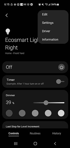

@nayelyz I’ll demonstrate with light bulbs. It happens occasionally when you open devices details page first time. Same device 10 seconds between loading details page.
It doesn’t matter which/who’s driver it is. This happens even with a stock ST drivers.
Exactly what @milandjurovic71 shows except mine won’t show the driver until cache is cleared.

I have same model bulb almost everywhere. First couple that I checked had Driver in menu. 4th or 5th one did not. I went back to detail page twice to get Driver menu. This was happening before latest app
