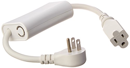

As it stands now, it looks like my best option is simply to get two of the old school DSC06106-ZWUSs since both could connect at once to the same outlet. It wouldn’t be pretty, but at least it could work. It looks like their new versions like the Smart Switch Gen 6 are much prettier, but they are flush to the outlet, and it looks like only one can fit, so that wouldn’t work for me. Any suggestions?
