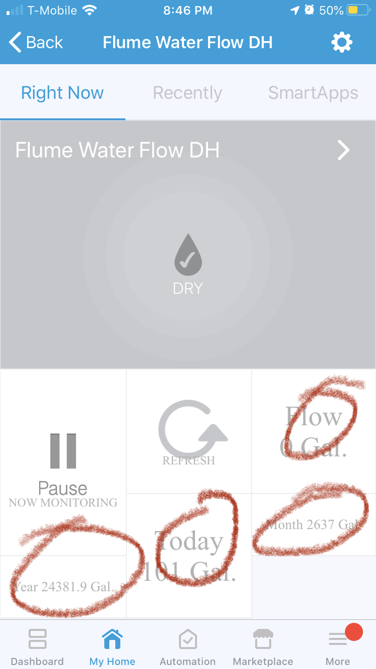

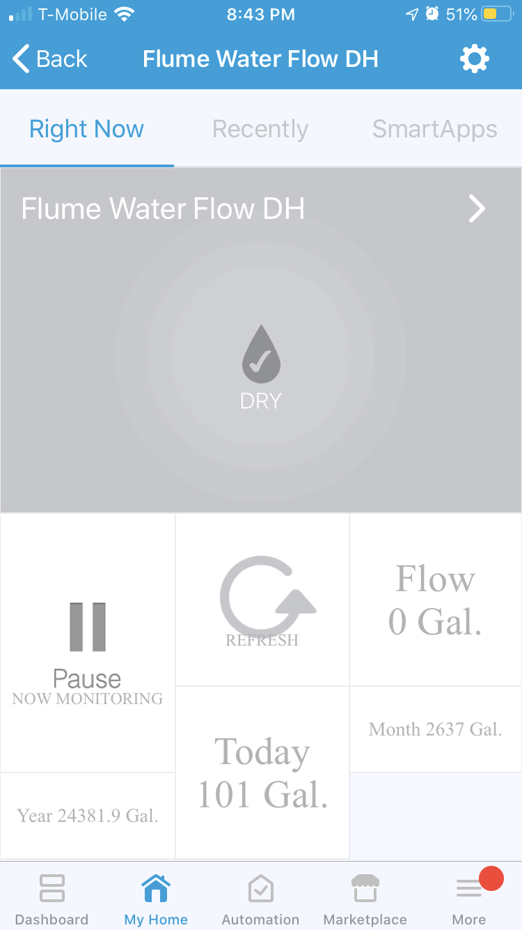

I’m trying to understand how to covert classic dth of Flume water meter
It works with dry/wet sensor capability but what about the additional info Gui elements as shown below? Surely this can’t be this complicated…
so that the tiles info show up on the new smartthing OneApp whatever it’s called…
