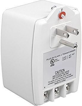

If no such Device exists, you could use a regular Z-Wave outlet or pocket socket and a 24VAC wall wart. The 24VAC wall warts were pretty cheap the last time I bought one.
This isn’t the one I bought last time but is an example:

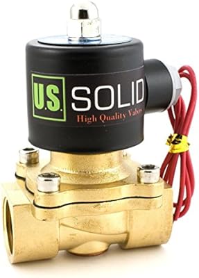

I was thinking about doing this, too. I put together a parts list to use for a project with soakers at a remote location where I won’t be present most of the time. I can’t wait until it warms up a bit and I can start getting to those outside projects! One of the things I like about a solenoid valve approach is that it fails closed if AC voltage is removed. The valve turners all stay in whatever configuration they are in when power is removed - that could be open! For my use case, there are intermittent power problems (rural living, yay). While I could put everything on a UPS (including my hub and internet modem), the cost of the project starts to rise above the point where it makes practical sense to me.
Like @JDRoberts was saying, you can find solenoid valves that you can drive directly off a smart switch without having to use a separate relay or even 24V AC power supplies. You might consider something like this:
