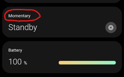

My main goal for now is when I use a momentary button in my driver, I want the button to be called for example ā€œLock deviceā€ instead of the default ā€œMomentaryā€ label.
Screenshot 2021-10-16 151628

At the moment, is not possible to patch stock capability presentation labels, but is something that our team is looking forward.
You’re right, this update would be applied through the patch attribute.
