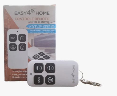

It’s probably a Tuya keyfob clone, like the Woox R7054 a user asked about here (but nobody replied apparently):
It doesn’t use the custom Tuya cluster 0xEF00 but the standard IAS_ACE cluster of Zigbee (surprise!)
It’s interesting since those unofficial Tuya drivers (made by SmartThings devs?) have some support for a SOS Tuya button, of course limited to a specific fingerprint which is a problem with all the Tuya clones.
The other three buttons of the keyfob are the Arm command with the different arm modes that are not handled.

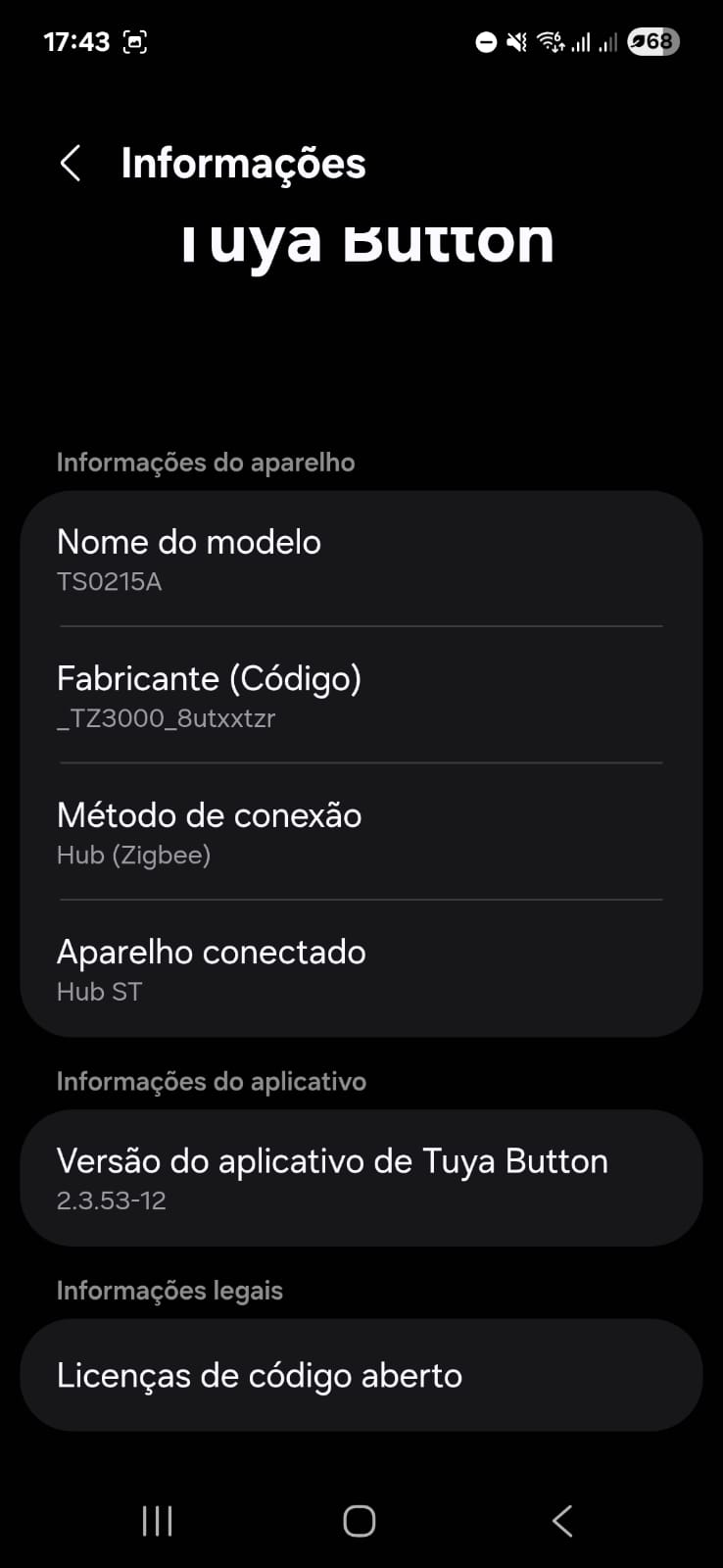

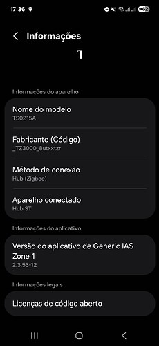

Try the Tuya Zigbee Device (Snapshot Tuya Zigbee Button) from my channel and delete and re-add the device in the ST app.
It’s a snapshot of the stock driver + the fingerprint of your device. I don’t want to put too much work into a Tuya driver, so the arm/disarm buttons won’t work. At least one of the buttons should work and you could just toggle the state.

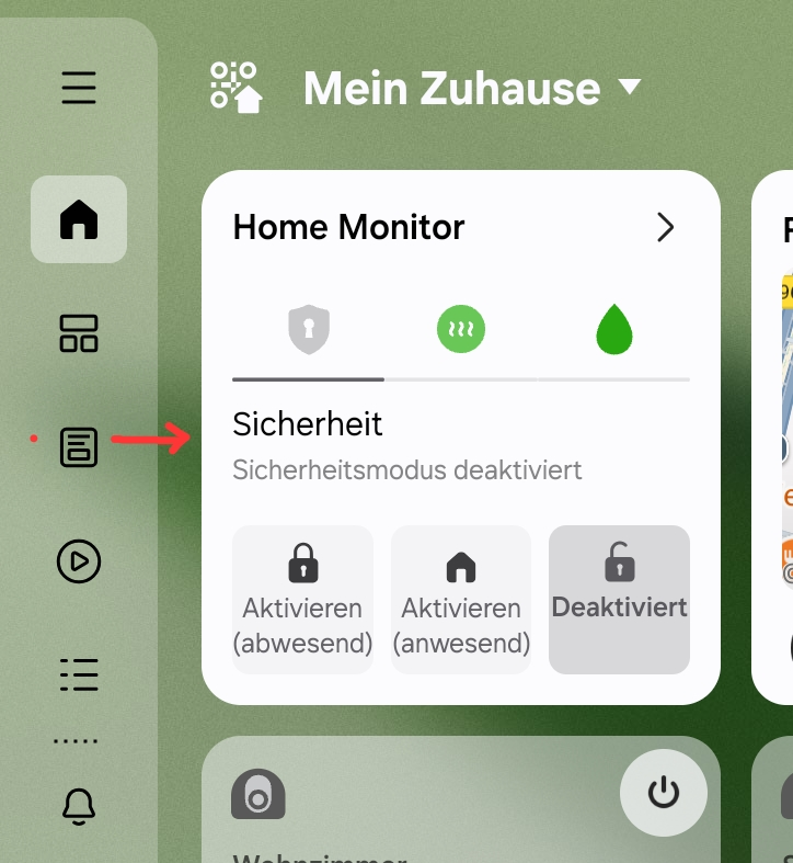

SmartThings Home Monitor

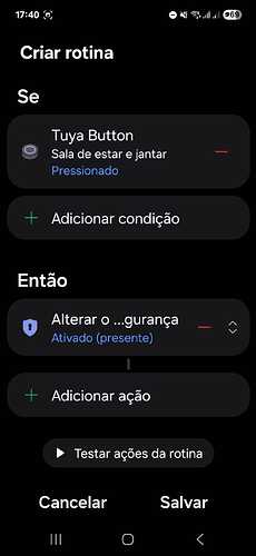

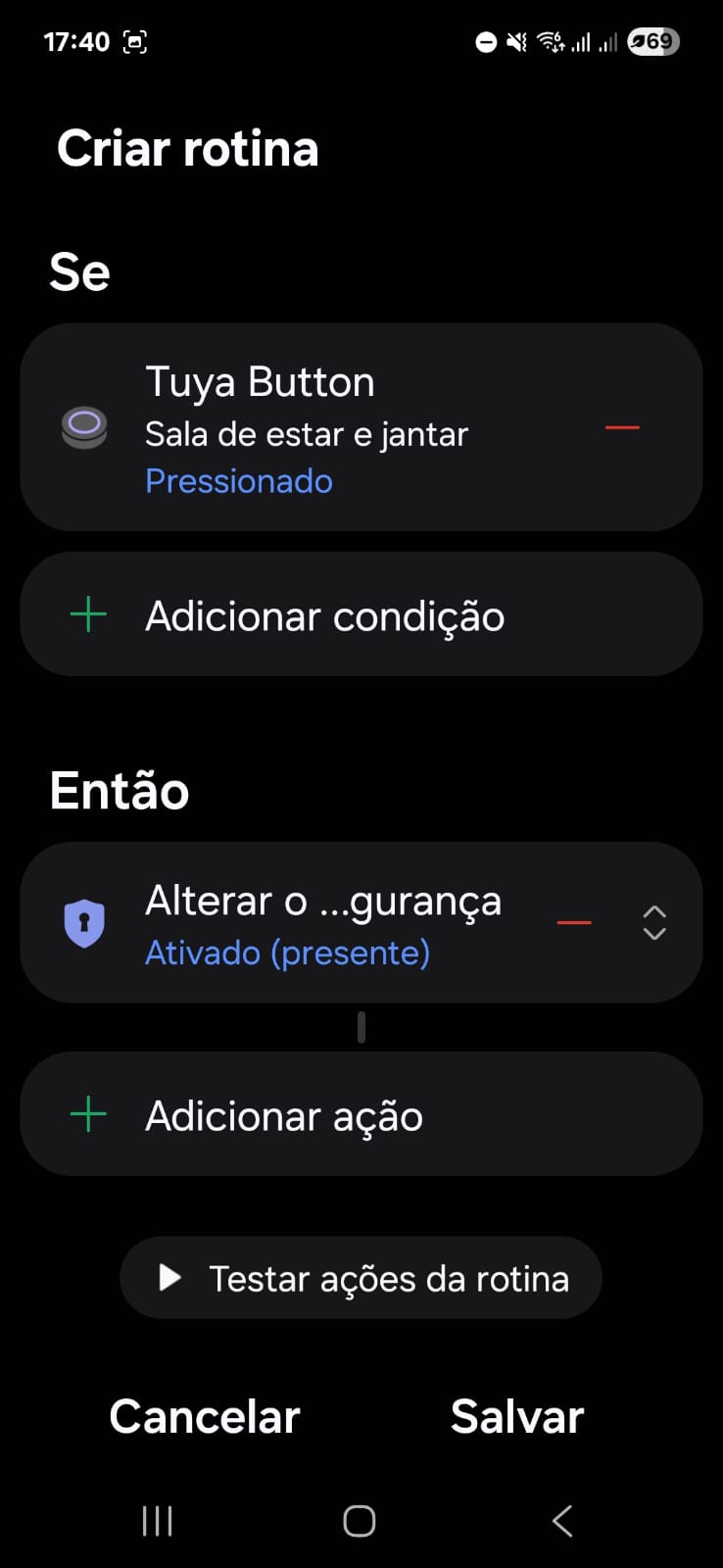

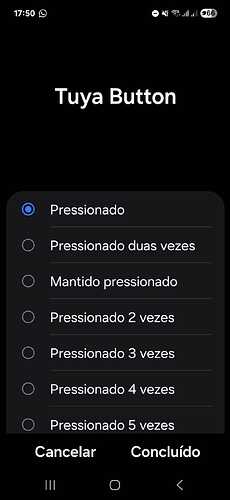

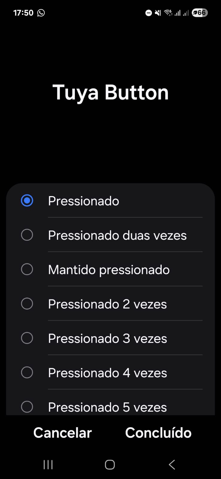

The device found its drive, and I was presented with many options: single tap, double tap, long tap, and many others. I tried all of them, creating a simple scene. When pressed, the lamp turns on. However, no scene was triggered, regardless of the button or single or double tap.

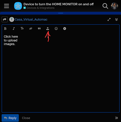

Click here
to upload
images.
Looks pretty good to me…

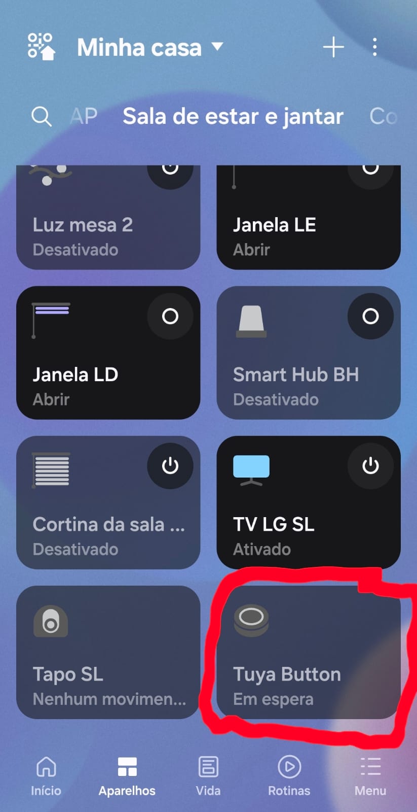

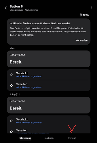

Show us a screenshot from the device detail view and the events tab:
In the routine actions available it should only show the “pressed” and not the other ones. That means the added_handler of the meian-button/init.lua is not called or there’s an error somewhere. That file also has the fingerprint in it.

there is no history
